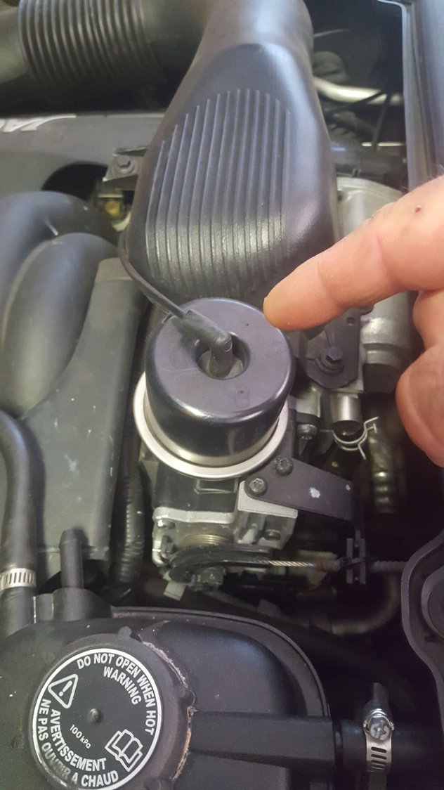

I assume you mean the small black cable that plugs into the silver can by the throttle body... it’s on OK.
Tony

This is the hose.

Thanks for the photo.. my pipe is connected. I’m assuming that is a vacuum hose. So I need to investigate further. I assume that means taking off the pass side wheel and inside wheel cover off. But, I’m not sure what I’m looking for.

The hose your searching for is located on the the throttle body elbow half way down and close to the intake manifold. It connects to the vacuum bottles. First remove the intake snorkel for a good view. The search for an open tube on the throttle body or a small cracked hose. It isn't the tube to the control canister.

Thanks Vern.... you nailed it ... the plastic tee on the vacuum hose under the air snorkel was broken.. problem solved.
