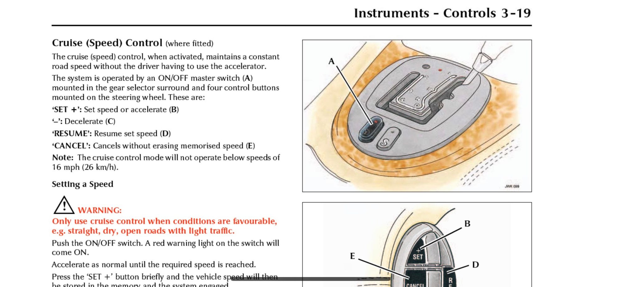

TO JOHNKEN and Ledmi, I apologize for taking so long to respond, but sometimes family matters supercede my needs. As to my cruise control not working, when I start the car the cruise control on/off master switch comes on and stays on, as does the sport mode next to it. When I start driving and reaching speed about 55 mph I press the + set switch, cruise control does not engage, the light in the on/off master switch goes out (sport light is also out) and pressing the master switch will not bring the light back on. I have not changed any bulbs or tampered with the electrical system. Any ideas?
Old Aug 31, 2022 | 11:55 AM
Ledmi's Avatar
Joined: Dec 2018
Posts: 127
Likes: 56
From: Montréal
Default This is not cruise control switch
The switch beside the sport mode is the limiter speed.
i recommand that you take the owners manual and read the cruise control section and the limiter speed section too
Old Aug 31, 2022 | 01:57 PM
zray's Avatar
Joined: Jan 2018
Posts: 3,759
Likes: 2,350
on my ‘02 XKR , and confirmed by the owners manual section 3-19, the cruise control master switch is indeed indicated to be next to Sport Mode switch. Don’t know about the OP’s ‘98 model.
Z
Old Aug 31, 2022 | 08:50 PM
OldCoot's Avatar
Joined: Oct 2021
Posts: 350
Likes: 576
From: Ohio
I have indeed read my "Divers Handbook" on cruise control and page 29 clearly shows the "on/off master switch" located in the gear selector surround and next to the "sport mode" switch. I have also checked the throttle bod vacuum hose, and all seems ok there.
