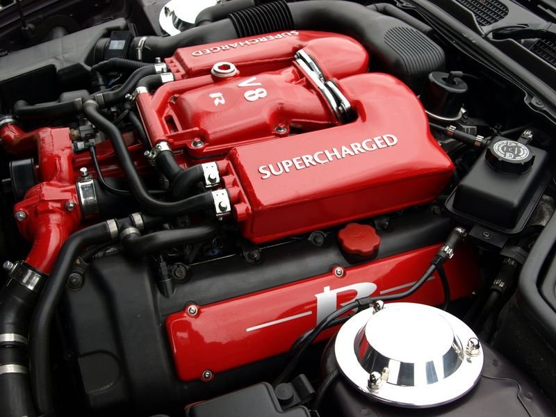

I've been very impressed by the engine detailing by XKRacer (Paragon Design UK), as exemplified in this photo:
I've especially lusted after the alloy coil covers with the "-- R --" logo that Paragon sells for £400 -- about $550 at today's exchange rate.

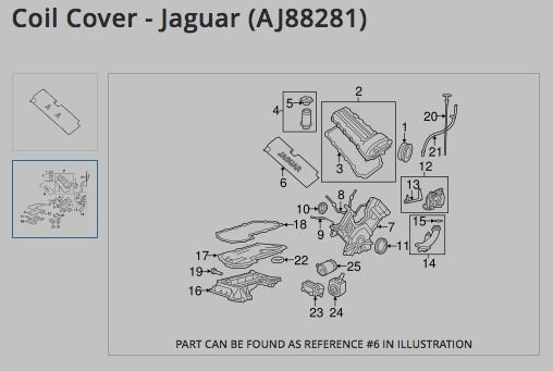

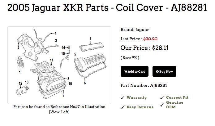

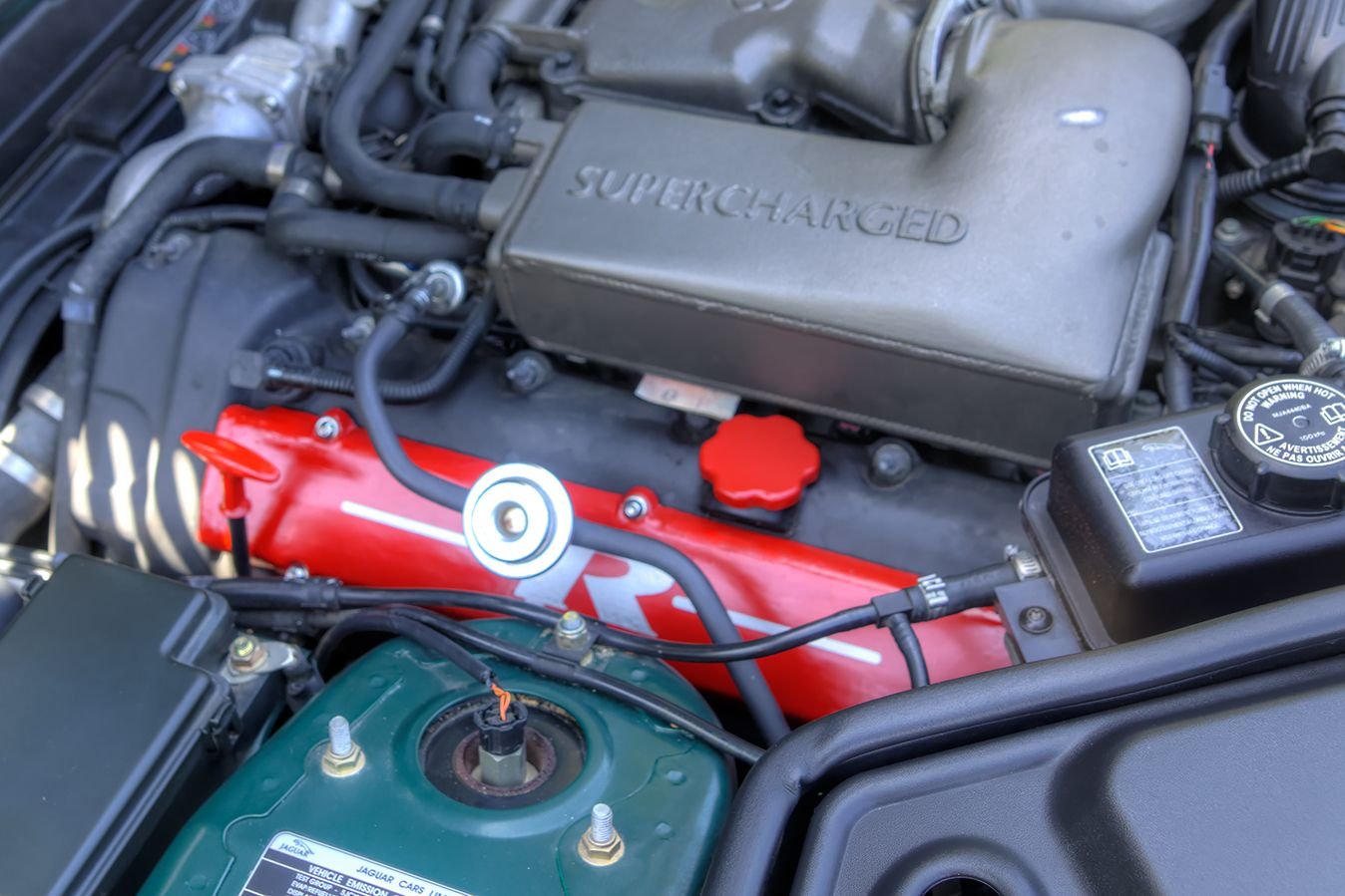

Recently, however, I found that Jaguar makes two styles of plastic coil covers that fit my XKR. The ones I have are parts number AJ86177 (right) and AJ88281 (left). The alternative coil covers are parts number AJ88281 (right) and AJ88280 (left). Yes -- that's right. Two parts that look completely different share the same part number (AJ88281).
(To further confuse matters, there is no difference between AJ88280 and the "alternative" AJ88281.)

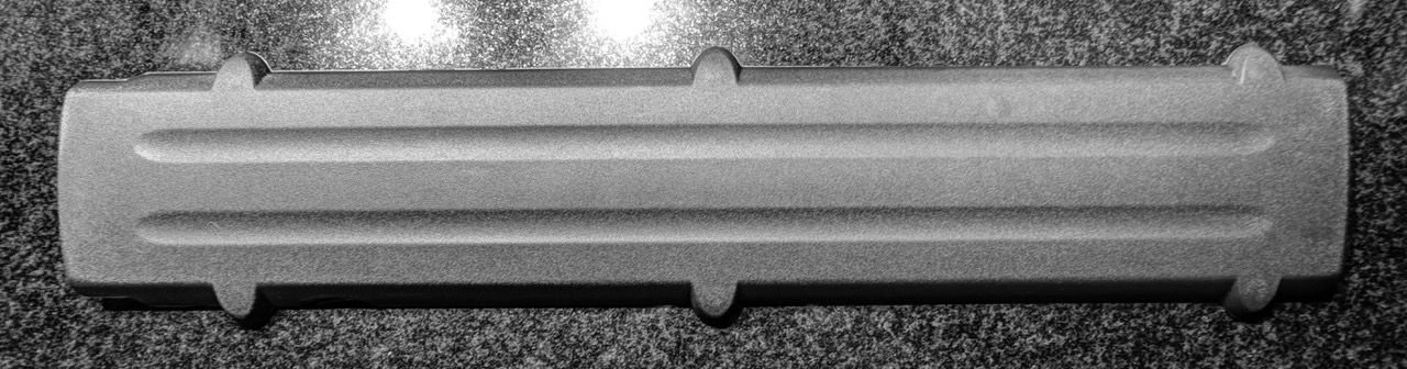

I then had a thought: perhaps I could modify a couple of the alternative (plastic) coil covers to look like the alloy ones made by Paragon, using fiberglass. (I had experience with fiberglass from building a couple surfboards in high school.)
The parts I received had two parallel grooves running the length of the cover and a rough textured surface.

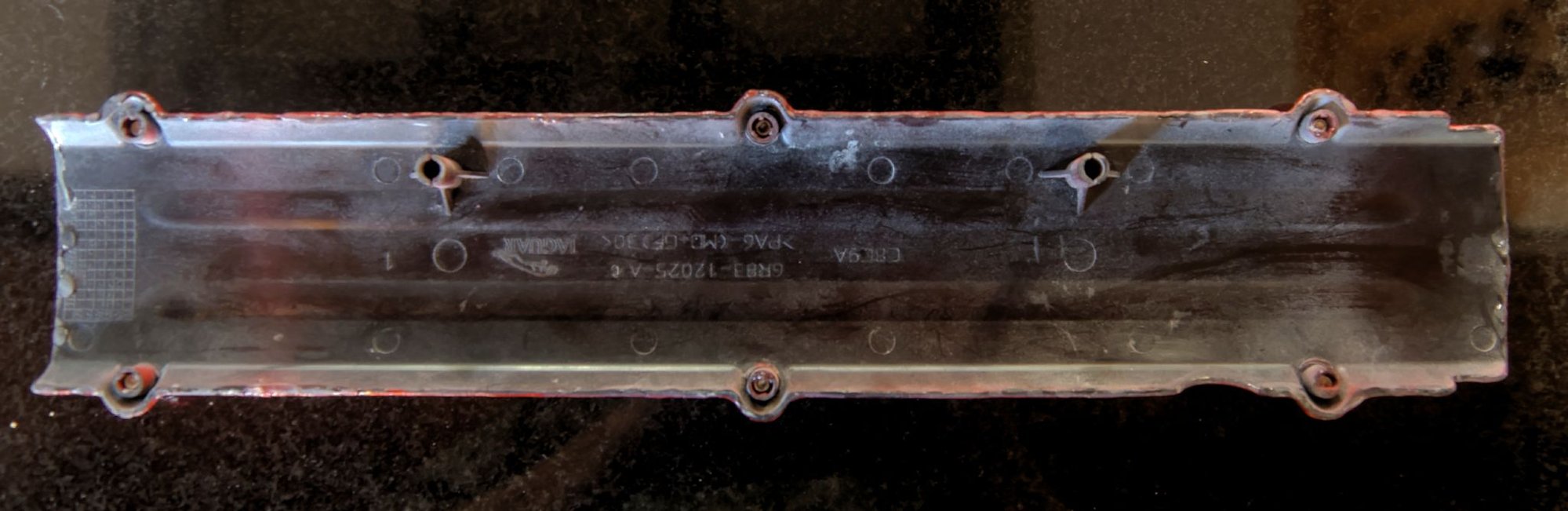

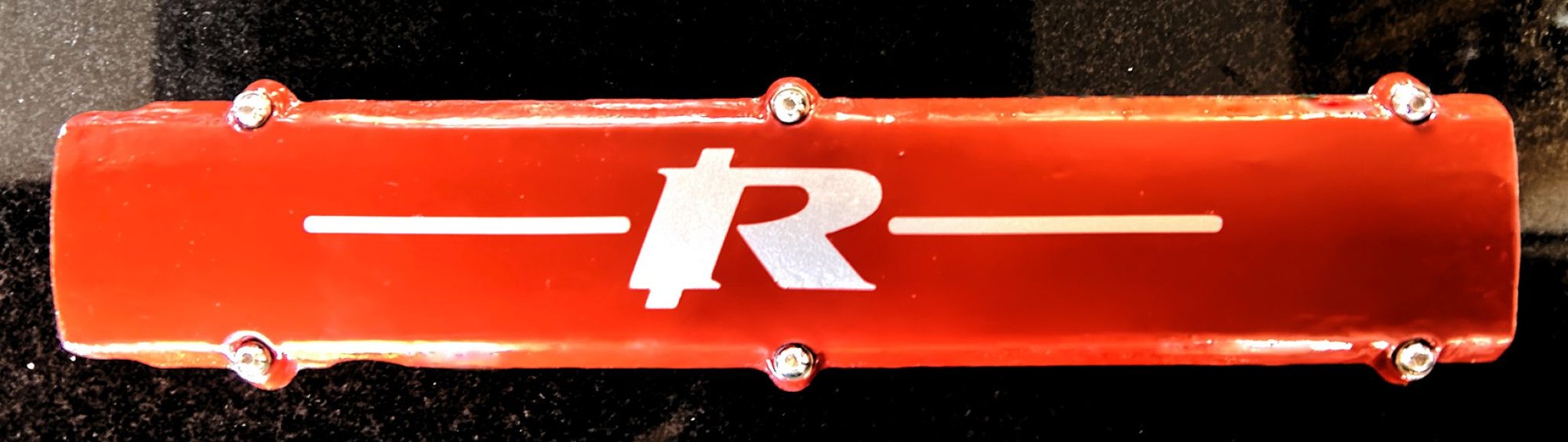

Without going into great detail, I used Bondo filler, fiberglass cloth and polyurethane resin, plastic adhesion promoter, 2K aerosol polyester primer surfacer, 2K aerosol high-temp gloss red engine paint, decals with the silver “—R —” logo, and chrome screws and washers. I also used a Dremel tool with grinding bits, a cordless electric drill with sanding discs, sanding sponges, and a filter mask (for sanding) and a respirator (for applying the paint).
(I found a guy on the UK eBay site who makes decals of the "-- R --" logo for brake calipers. He was able to enlarge the logo and make decals the size of those on the Paragon coil covers.)
Here is the result:
The photos show that the chrome hardware on my covers isn't functional -- it's purely "for show". Instead, the cover still snaps onto the posts protruding from the engine.
And here's what it looks like installed:
Next project: painting the supercharger and thermostat housing the same gloss red.

In my post, I forgot to mention another advantage of my "faux metal" coil covers -- because Paragon's coil covers screw onto the valve covers, the only way I could use them would be to swap out my valve covers (with the snap-on posts) for the older style ones (that accept screws) at a cost of around $700. Just can't justify over $1,200 for a couple of fancy coil covers...
