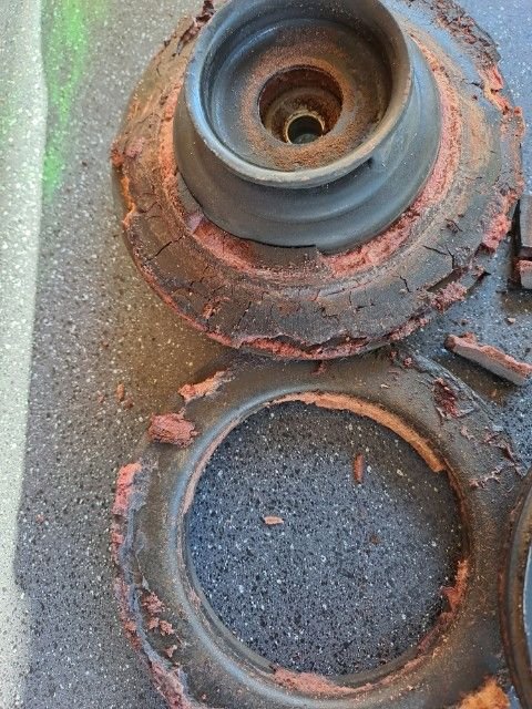

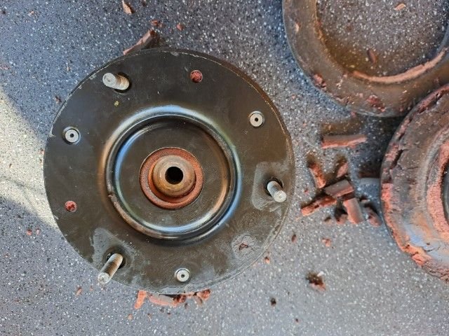

Today my son and I removed the front struts to replace Shocks, Springs and top mounts.
The top mounts I am sending off to (Baxter) here in Oz to do his thing.
Here are some pics of what we removed and as expected the Strut mounts were way past their use by date.
Steve will post info himself on this refurbishment and I will post pics of it all going back together. Complete with the new and improved top strut mount.
Good luck with these Steve.
