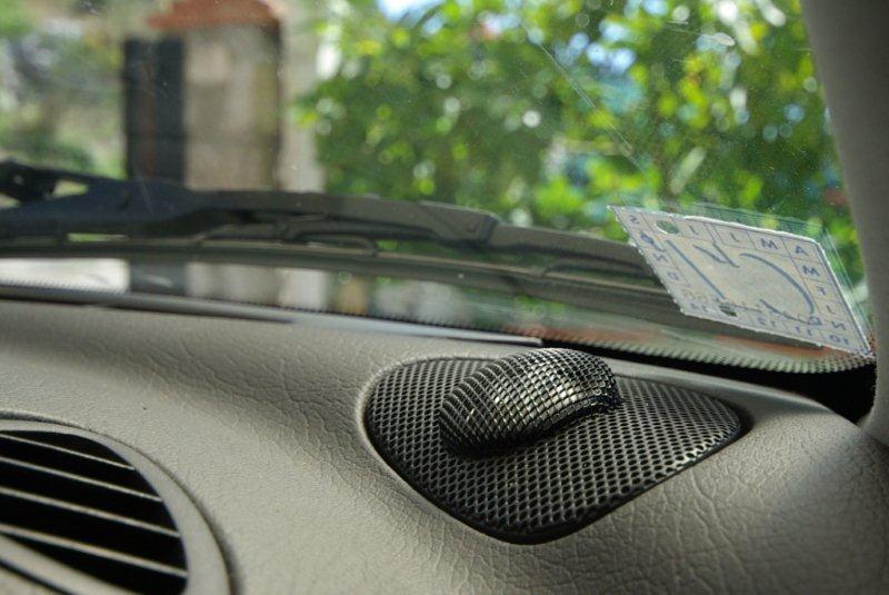

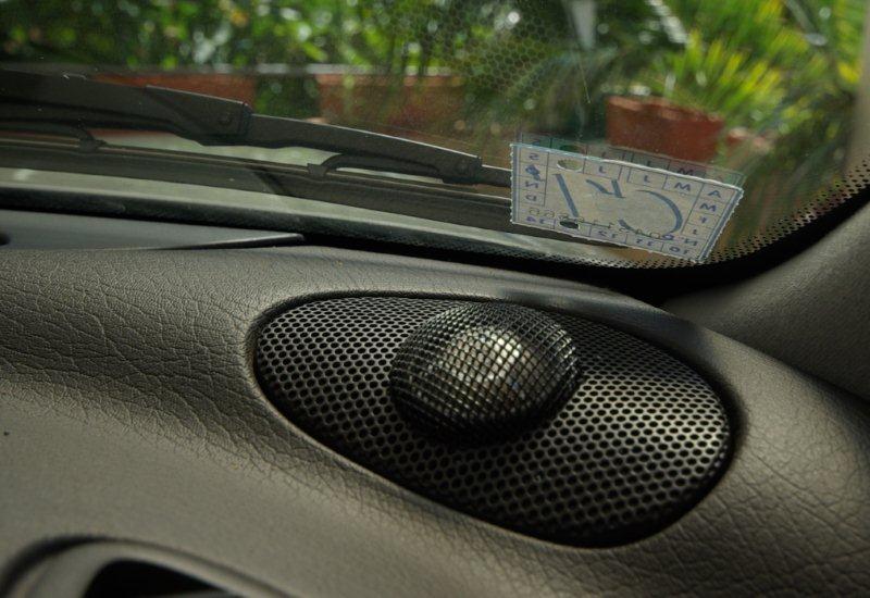

I used the facia grills and drilled a 1 inch hole in them.
I bought some JBL tweeters and they fit nicely in there.
The tweeters stick out slightly and have a black grill so all in all it looks very good.
Unfortunately I don't have photo and I'm out of the country so I can't take a picture.

exactly, it is the about 2,5 inch plastic grill on top of the dash.
Originally there was a super low quality tweeter fitted, my new 1 inch JBL GTO tweeter did not fit underneath nor in the door's tweeter grill so I drilled a 1 inch hole in the plastic grill on top of the dash so the tweeter is penetrating and slightly facing towards me.
hard to see on the photo, but that is the location

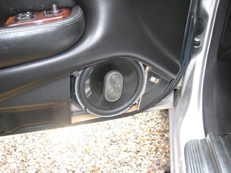

Oh yes it makes a difference. buy a good set of tweeters and hook them up with the filter to the existing wiring.
You can also consider buying a compo set as that is sometimes cheaper, then take out the correct condensator out of the 2/3 way filter and put it in series with your tweeter.
The wiring should already be connected in parallel to your existing speaker wiring as the wires are already there.
if not, then it is a matter of connecting them under the armrest.
Fairly straight forward and for sure an improvement to the sound.

Right, I found the pictures of what I had in my archive
Attached Thumbnails Dashboard Speakers-tweeter1.jpg   Dashboard Speakers-tweeter2.jpg   Dashboard Speakers-doorspeaker.jpg
