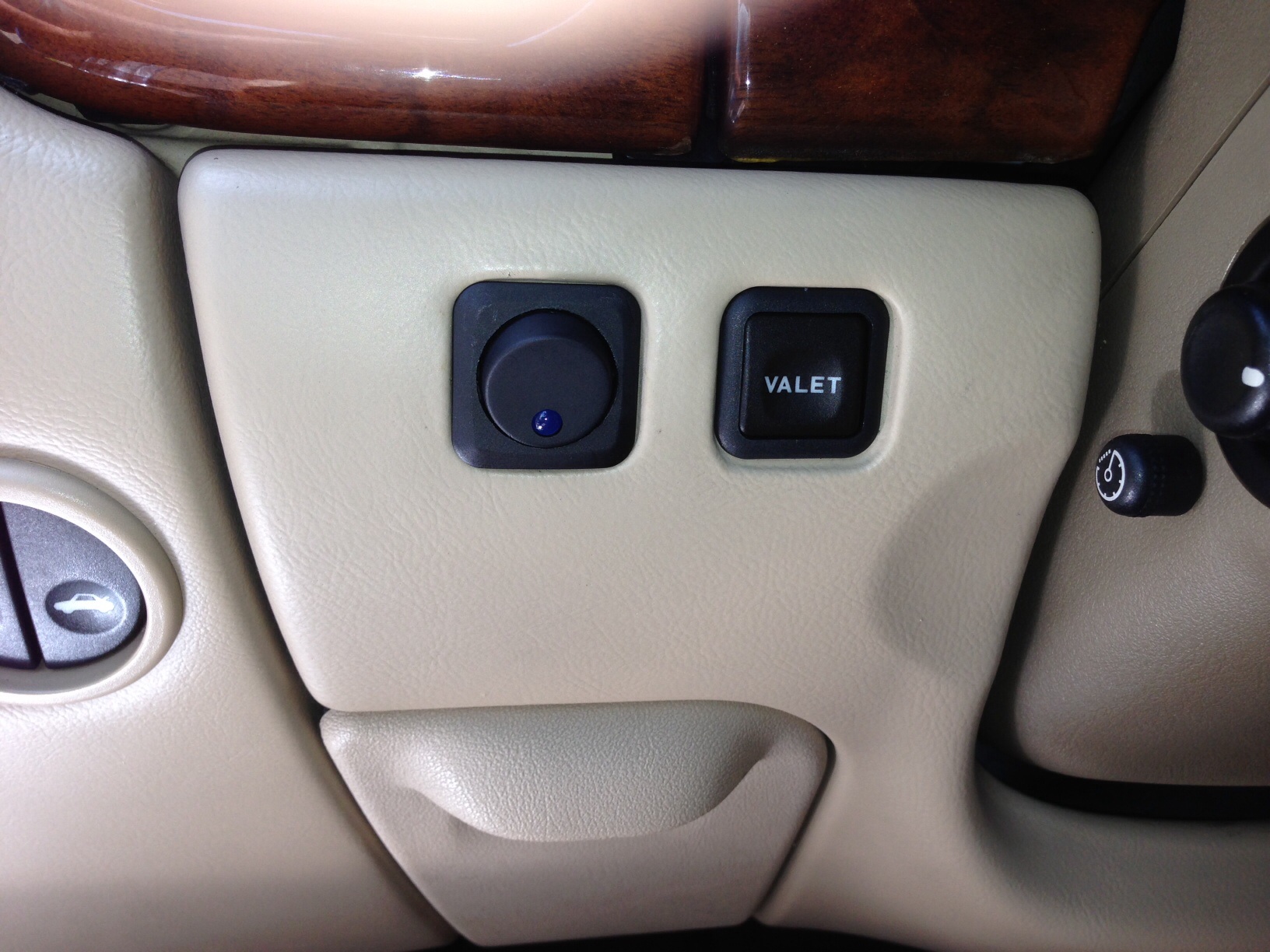

I installed a switch to have my front fog lights on anytime the car is running. Very easy to do, the indicator light comes on on the stock switch and if I turn off my installed switch the factory switch stills works the same as stock. I even found a rocker switch that fits the empty air vent hole on the lower left dash beside the valet button perfectly, looks stock.
If interested reply and I'll provide details.

Yes but on a left hand drive the AC Sensor is on the right and the valet is on the left with an extra vent hole next to it where the adaptive CC switch would be if installed.
Attached is a photo of the switch I installed. Looks like the factory installed it. I put in a lighted switch with a blue LED just for the heck of it but as the light on the factory switch also comes on the blue LED bothered me at night so I disconnected it. The blue reflected in my window exactly where the mirror is an I kept thinking a cop was pulling me over. I'll do a quick wright up of how to wire it later tonight.

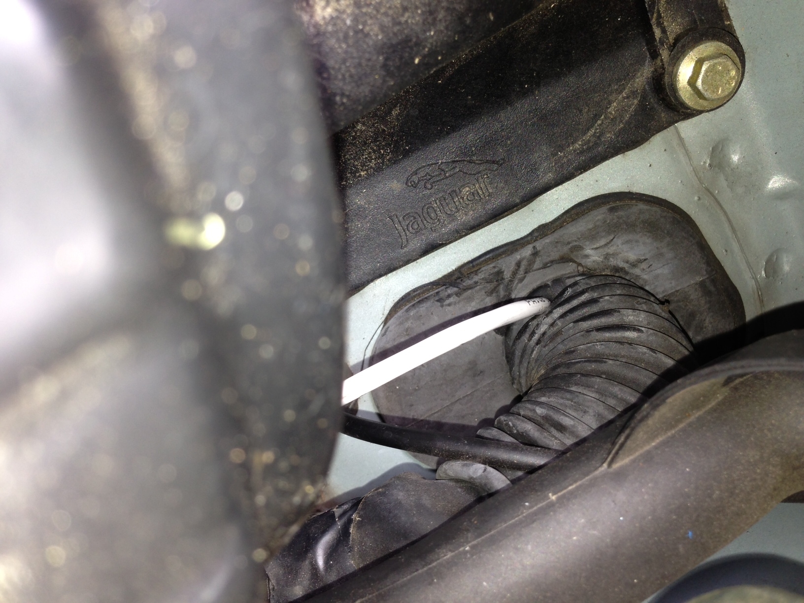

OK see attached and photos. All you are doing is switching a ground to the Orange with green stripe wire on the white connector under the engine fuse box. As we are just switching a ground you can't hurt anything. When the switch is on anytime the key is in position 2 the Fog lights will be on and the little yellow light on the console fog light switch will be on.
In my state it is illegal to have fog lights on when the high beams are on so when driving at night be aware that as long as the new switch is on your fog lights will not turn off with the high beams.The console fog light switch still works normally to turn on the fog lights when the lights are on.
The easiest way to get a wire to the dash is to thread it thru the firewall connector as shown in the picture. This comes out inside the car just behind and above the hood release.
