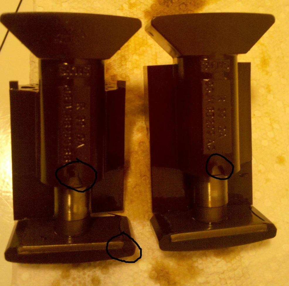

Originally Posted by Spinakerr
I budgeted for the major work - tensioners, gearbox and wishbones for the first year. The only question is, although I am ok with spark plugs/oil changes/brake discs I'm not up for the tensioner work myself.
Don't feel bad about that - I just paid a dealer to do my secondaries here in NC. I would rather have attempted it myself, but this is my primary ride so could not risk being without a car so had to cop out & hire a pro. But the dealer had the best price, believe it or not, and I know their shop does several of these jobs per year so no guess work or unexpected delays for parts, etc.
The damage was not bad and I probably could have gone several thousand more miles, but as you can see from the photo there were faint cracks that would eventually lead to trouble. There is just no way to know until you get the cam covers off, and by then you (or your shop) might as well go all the way since wear and tear is often hidden from full inspection. My car has just over 70 thousand miles. Since you have more than that already, you might want to think about tackling this job first. If it isn't your primary transportation and you can deal with a possible delay, it's a do-able job with the right tools, time & place, based on what's been posted in this helpful forum.
