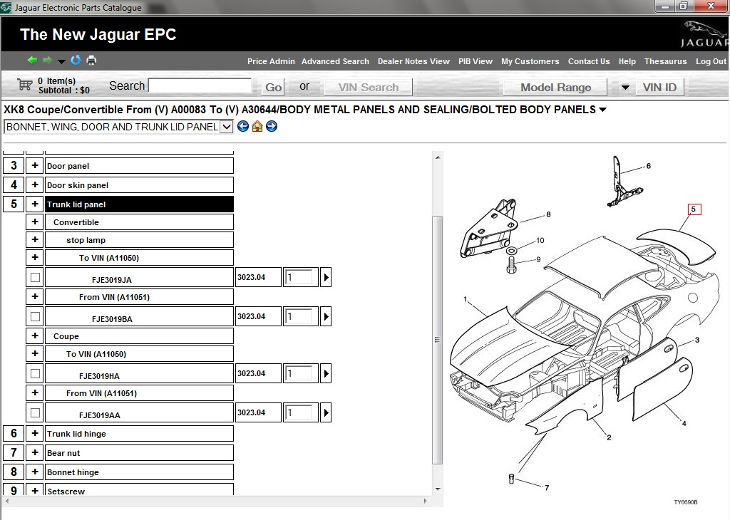

Do any of you know if the decklid from a 2001 convertible xk will fit on a 2000 coupe?
I would like to be sure before making the purchase, and I have never tried before.

Looks like the coupe and convertible are different part numbers. The vert has the 3rd brake light mounted, so it may be that is the only difference but you may end up with some extra holes.
