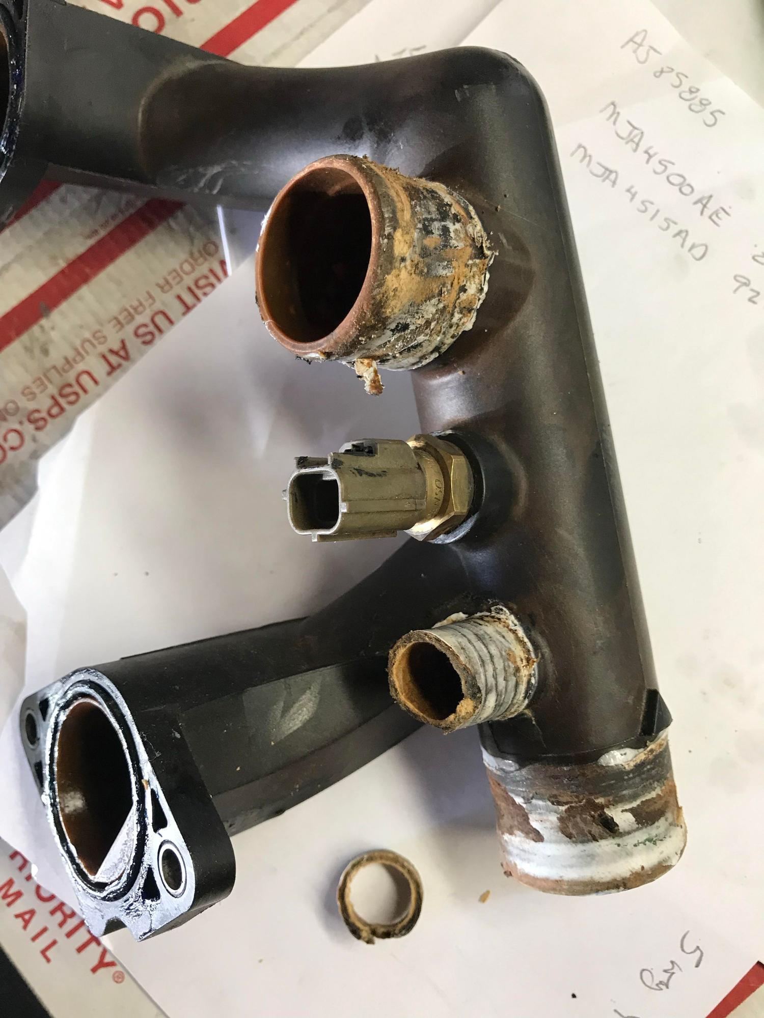

So this week I got it all reassembled. Refilled with Jaguar coolant and started up, and noticed a slight leak from the outlet pipe where the top radiator hose attached. I decided to get a new outlet pipe.
Removed old outlet pipe and it was crumbling apart as I removed it.

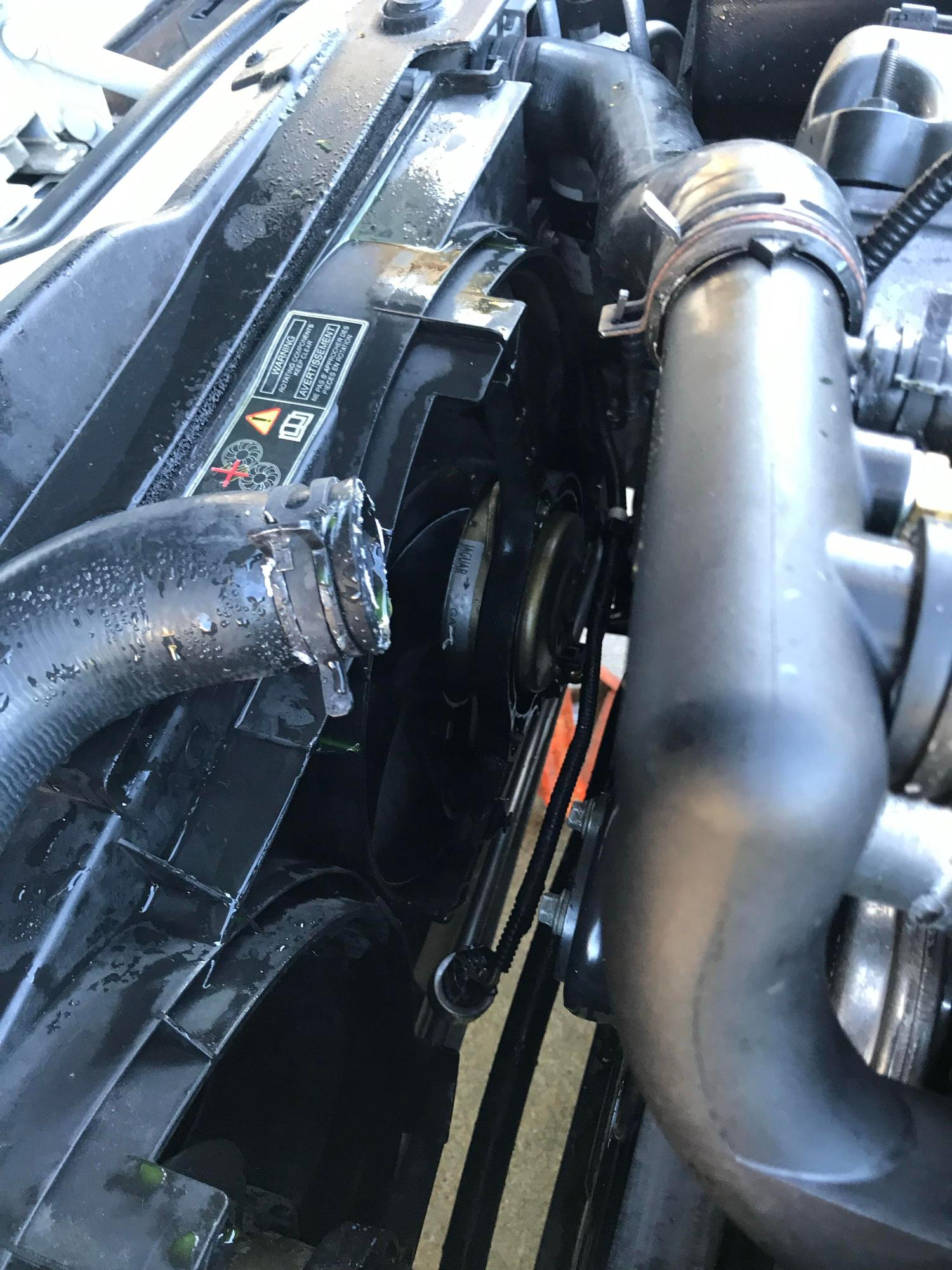

I replaced with new pipe, the car warmed up well and I could check the tranny fluid level. Turned off engine and let car cooldown. Then I noticed that the lower radiator hose had collapsed. The radiator hoses were replaced 8 years ago. I decided to get a new pressure cap for the reservoir to see if it was malfunctioning. Mine was original.
Got a new URO cap and installed. I started the car and noticed that the lower radiator was under significant pressure when hot. I checked the overflow bottle in the wheel well and the level had not changed since cooldown. Within one minute the lower radiator hose was blown off its connection to the thermostat housing and I lost most of the engine coolant.
I will get an authentic Jaguar cap and new radiator hoses.
My lower radiator hose was from Jaguar in 2014 and it has only two bends in it unlike some others I have seen online for 2001 XK8.
