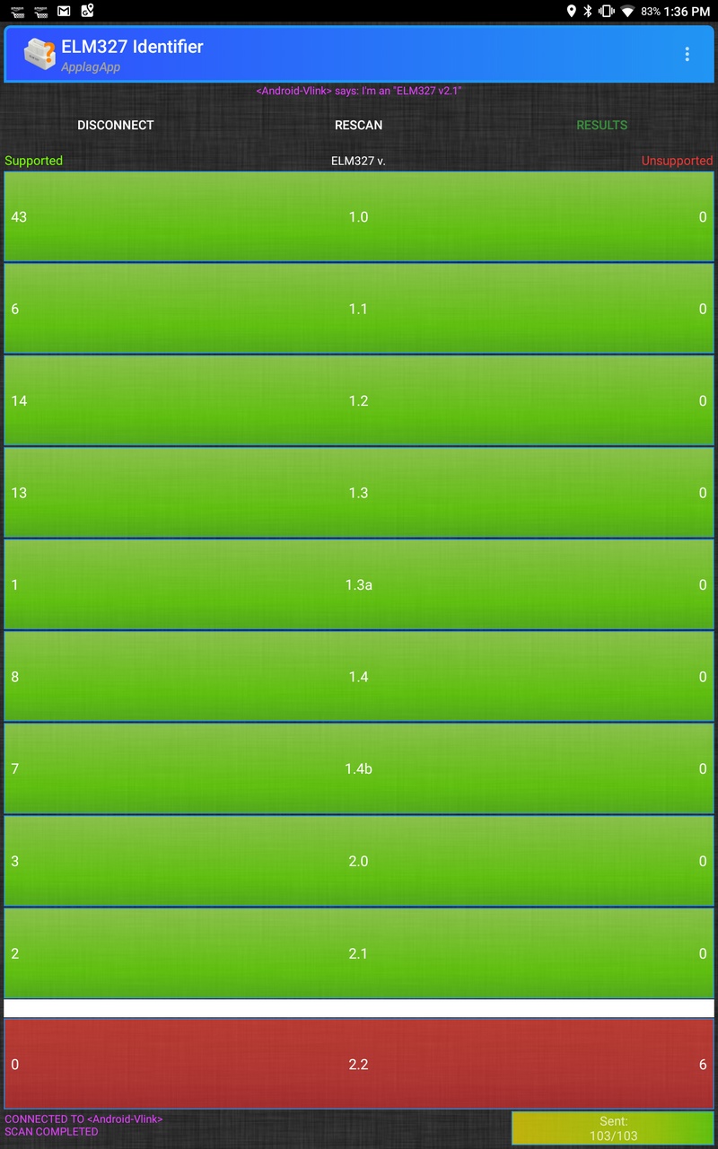

Mitch, it all depends on your wallet. A Jaguar/Range Rover-dedicated OBDII scanner ($115 to $1,000+) will give you the most options, including ABS and SRS, etc. These would include the iCarsoft i930 or LR II, the Foxwell NT510, and others. Having said that, a really good miniature Bluetooth or WiFi reader (plus compatible 3rd party app for your Android or iPhone) will allow you to identify and clear many issues, plus it will allow you to monitor active data while driving. And they are easier on the wallet. I have a $150 iCarsoft LR II scanner which I really like, but is too large to use in the car all the time. I have tried a few of the inexpensive Bluetooth OBD readers for smartphones, and settled on a "TONWON PRO OBDII Bluetooth 4.0 Scan Tool for iOS and Android". I purchased it from Amazon for $28, which is fantastic for the money. I tested and found it to be a true ELM327 v2.1 device, with true Bluetooth v4.0 connectivity. It works well with several no-cost/low-cost smartphone diagnostic apps, and it gives me the capability to read and clear a large number of errors. And it's really nice to have the capability of monitoring coolant temp, voltage, charging current, fuel consumption, fuel trims, manifold pressure, intake air temp, Oxygen sensors, and more while I'm driving.

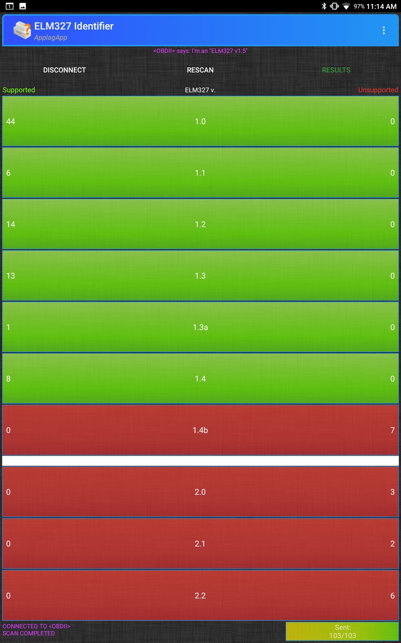

My other two units are really cheap ($10) clones. They both work (kind of) but are limited and unreliable. They will not allow me to clear any error codes even with sophisticated apps.
So, IMHO, an inexpensive, miniature Bluetooth code reader is the first thing to try. When searching for a good value, keep in mind that anything under $20 or that claims to be "ELM327, (and especially if it claims "v1.5" software), it is just a cheap, obsolete clone. ELM Electronics never made a v1.5 software version; they only made 1.0, 1.3a, 1.4b, 2.1, and 2.2. Anything else is a pirated version of their original v1.0, which was not protected from being copied.
This is not necessarily an endorsement of the TONWON PRO BLE 4.0 unit, but it is a true v2.1 reader, as tested by the available (free) ELM327 Identifier app, and is one third the cost of other genuine units.
Here's what a good ELM327-chipped reader (v2.1 or 2.2) should get you (depending upon the app functionality and the data made available from the car sensors...) (Note: Apps are beginning to provide auto-specific readings):

Also, test any reader you get with the free ELM327 Identifier app, and return anything less than full v2.1 functionality. Attached are the test results for my 3 units (two of which are for sale, by the way...). First one is the TONWON PRO...
