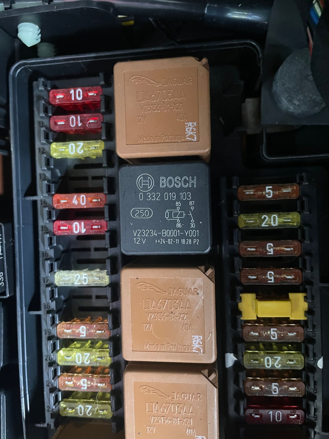

The relay I bought

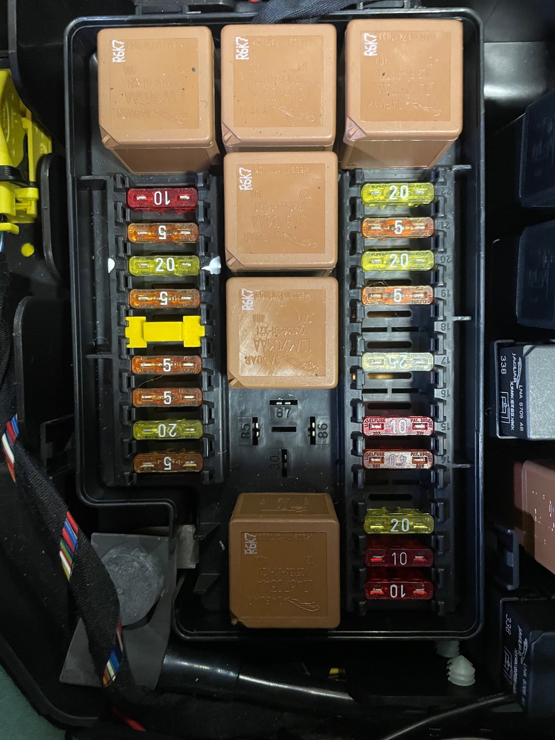

The relay installed in the luggage compartment fuse box. Note you may also need to put a 10A fuse in slot 17 in the same fuse box

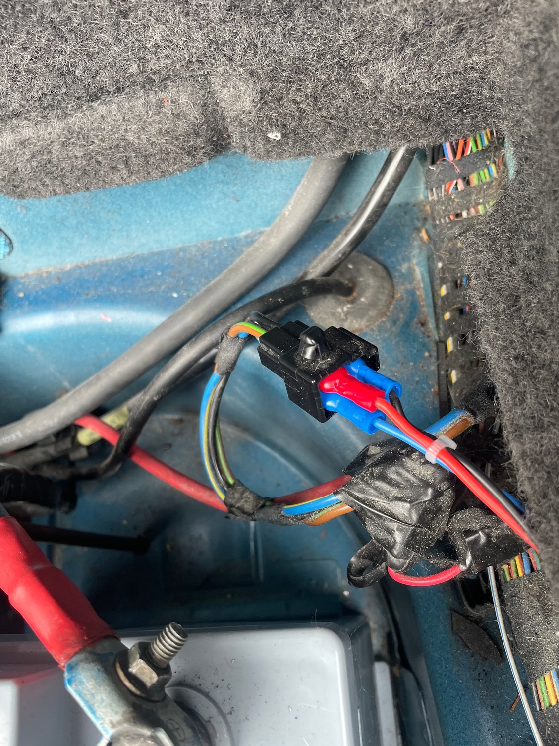

Here's the auxiliary connector. The top horizontal connector is the Ground (car wiring is black), bottom left vertical is the permanent live (Brown/Light Green) and the bottom right vertical is the switched live (Purple/Brown). There's enough space to simply insert individual insulated 6.5 mm female spade connectors if you don't have a three way nyoc connector.

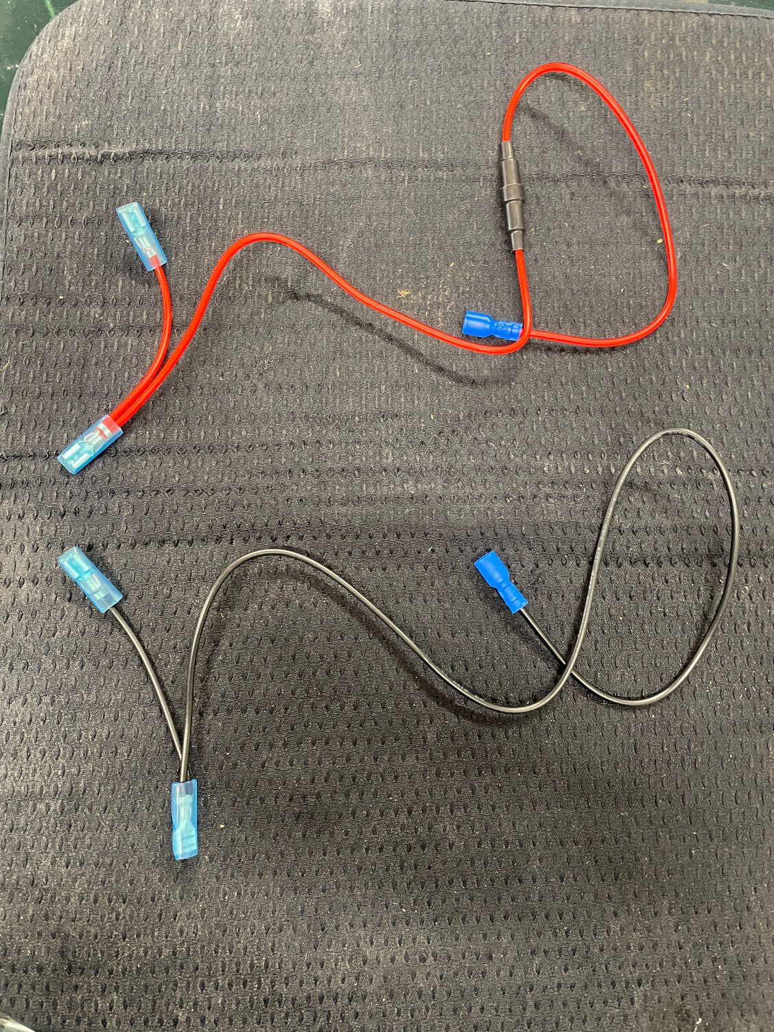

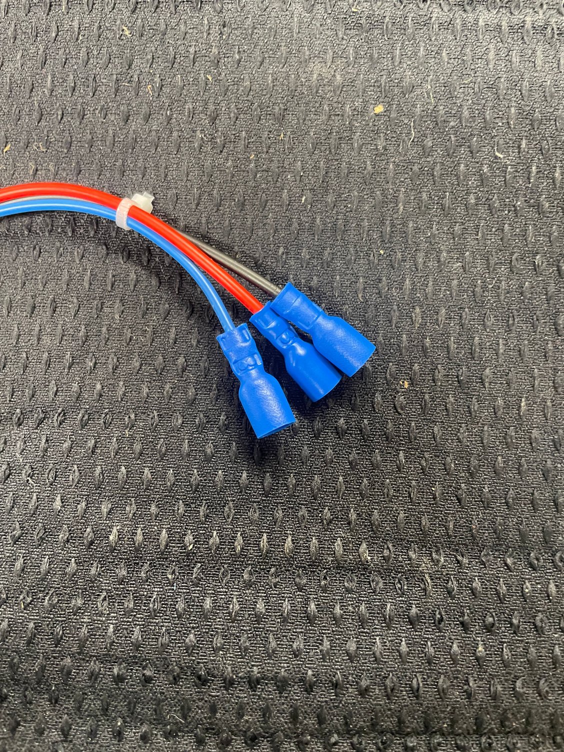

The dual port USB/Cigar Lighter solution I bought on Amazon already included these wires. All I had to do was to put a single female connector on the bare ends.
I added the blue wiring with the same connector for the switched live connection.
All that was now left to do was push the insulated connectors one to the appropriate male contacts in the aux socket and install and wire up the ports/cigar lighter as you can see in my previous post.

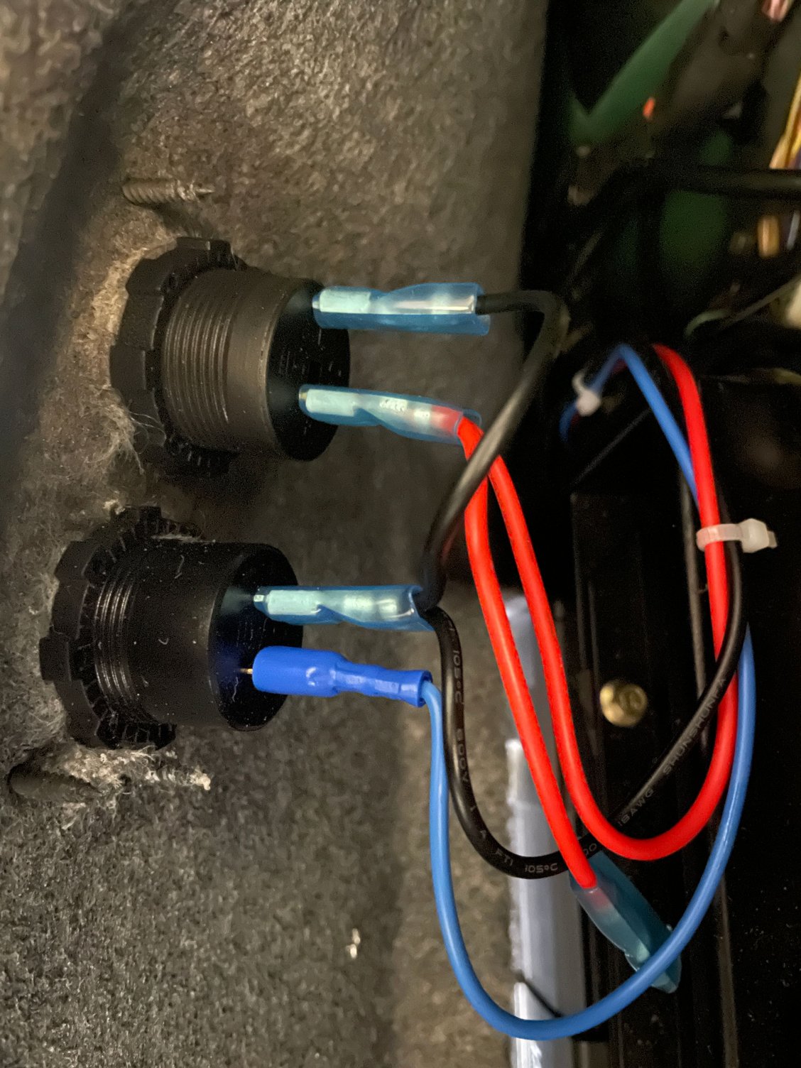

Pretty straight forward as to how I mounted the ports in the boot but I've attached a photo. Between the seats, I just drilled a suitable size hole in the base of the glovebox.

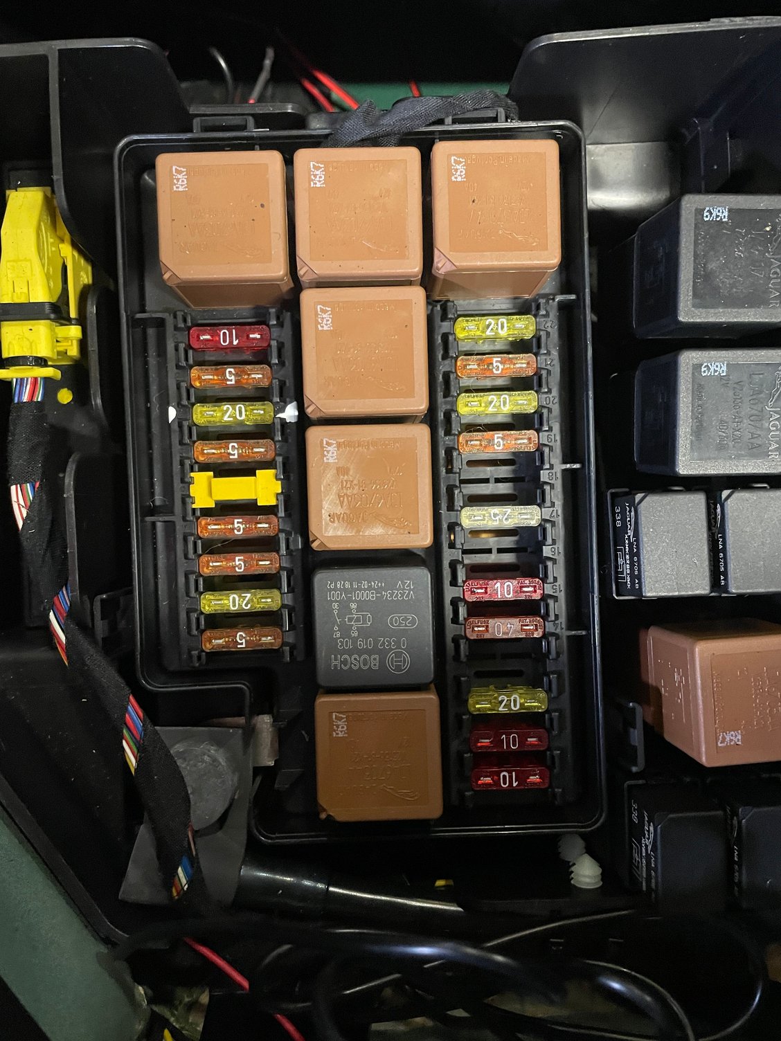

You don't need to attach anything to the relay. You should find an empty relay socket in the luggage compartment fuse box and that's where you put the Bosch (or cheaper alternative) relay. This controls both the connector behind the passenger side glove compartment and the one in the boot. You then just need to attach the cables direct into those connectors. I've attached further photos below:
Luggage compartment fuse box showing the space for the relay.
And with the relay inserted!
Here's a rear shot of the twin sockets shown in an earlier photo.
And these are the three wires (ground, permanent live and switched liver) attached into the auxiliary connector close to the battery positive terminal.

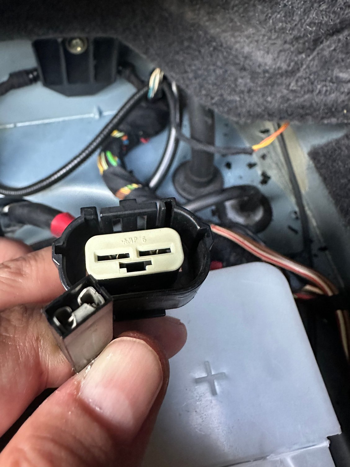

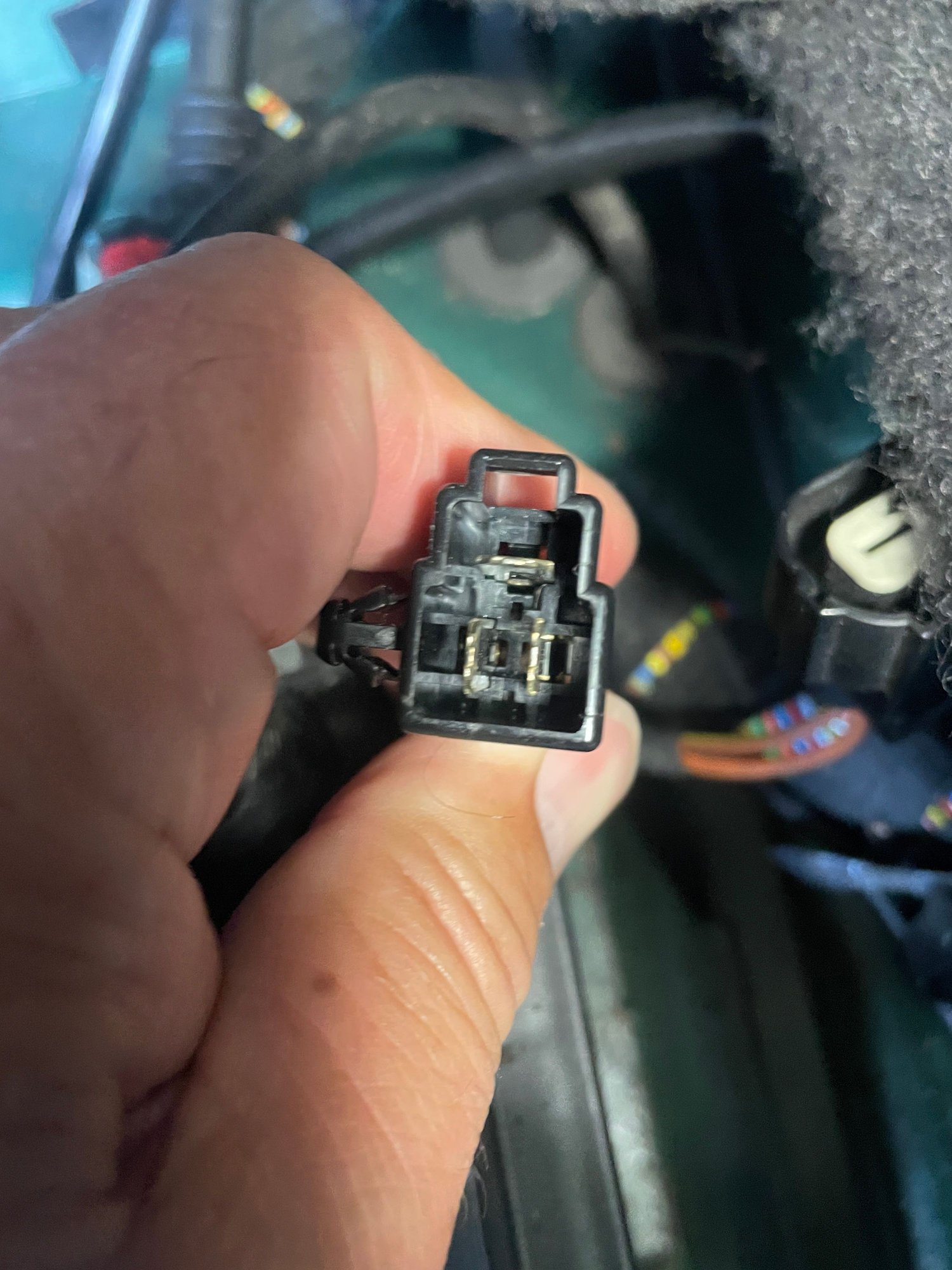

Default Don’t see the triple wire
I only see these.
These are not used.
