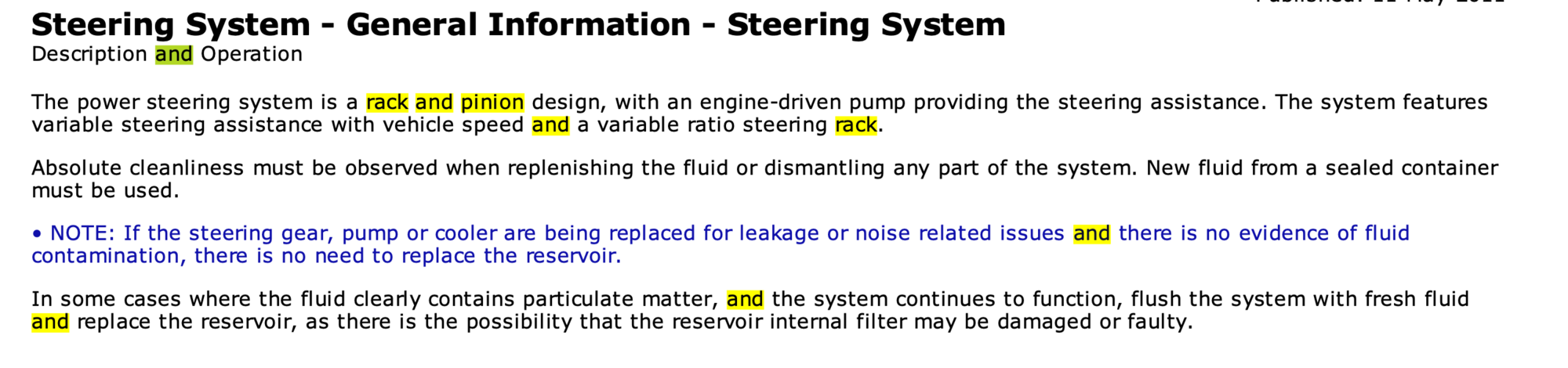

From the JTIS, I found this:
As far as I could determine, there was no evidence of contamination in my system. Nevertheless, I may as well replace the reservoir since I already bought it. In which case, I figure I could go ahead and flush the lines as per the instructions in the JTIS rather than replace them.
