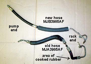

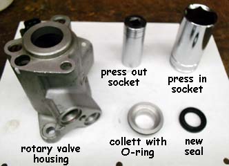

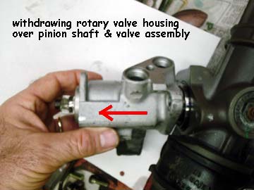

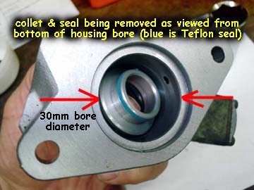

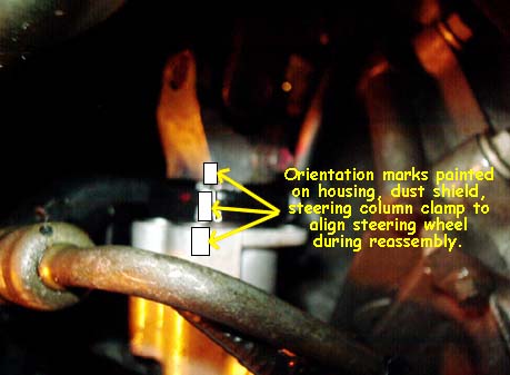

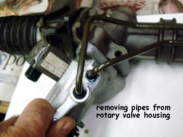

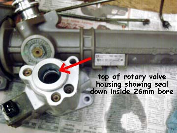

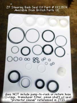

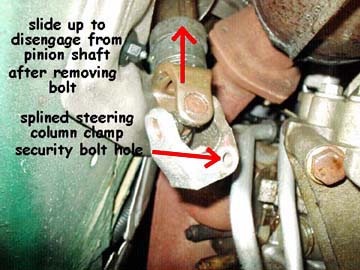

A few years ago, I rebuilt my 1997 XK8 rotary valve on my steering rack because of a leak. After rebuilding it and still having the leak, I found that the original fluid hose had cooked. It is a known issue and replacements are routed differently and away from the exhaust pipes. As additional precaution, I wrapped mine with aluminum foil to reflect the heat.
The rotary valve seal kit was from British Parts UK. I may have gotten the hose from Coventry West. Although it looks like a complicated job, it is fairly easy for any amateur mechanic who wants to save $$$$ over having the Jag dealer replace the rack. They do not rebuild them.
Attached is a complete procedure with photos. If the attachment doesn't come through OK, then email me at BlackRiverExp@att.net for a copy.
Bill Unger, 1997 XK8, 2007 XKR, 1969 E-type

here are the photos ....
