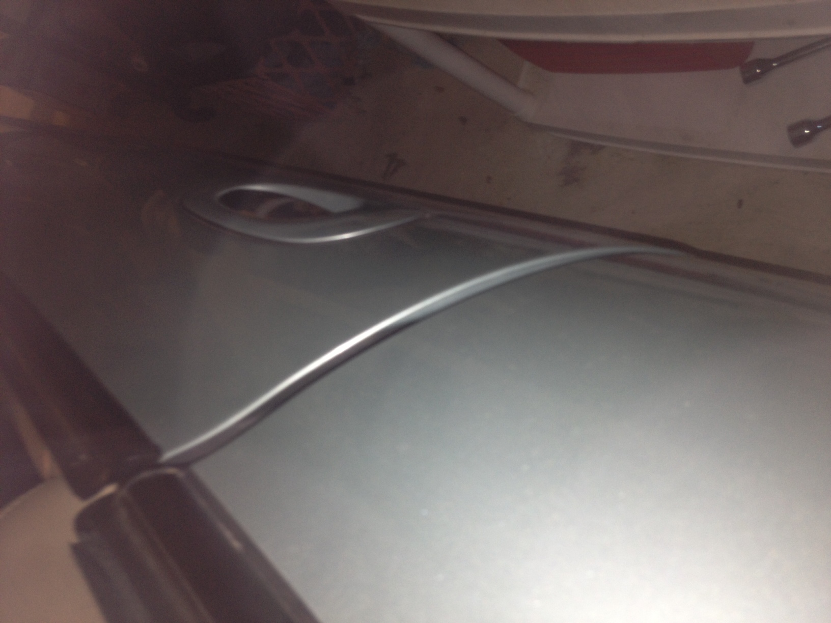

Hi all!
My 05' XK8 has slight alignment issue just at the top of the passenger door. No wrecks, perfect alignment, etc.
Is this a latch issue or any ideas. All else PERFECT. Any ideas?
Thanks.

If this in an inboard/outboard issue then it sounds like the striker adjustment that tberg mentioned in another post would take care of this and is pretty simple. But if is an up/down issue from other posts it sounds like the hinges which would be more involved.

thanks...don't know how I missed the recent topic in a quick search before I posted...I'll holler back at you all if I can't remedy this w/ data from last post!
