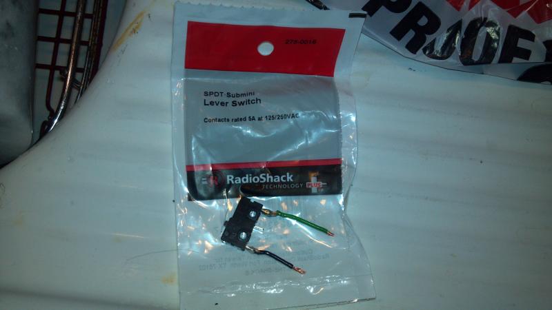

Default It CAN be done with a switch from Radio Shack if you're in a pinch!
I have a 2003 XK Coupe that was giving me a fit because of the faulty microswitch. The last straw was when I came out to my car yesterday morning in a parking lot to find the alarm going off and the passenger window completely down. I got fed up and took the door apart even though it was 28 degrees here with snow on the ground! Pulled out the bad switch, and carried it to radio shack. I found a similar switch(pn 275-0016), and soldered the green and black wires onto poles 1 and 3. (see pix) If you look at the old switch, you'll see that it is held in place on the latch assembly by a tab with two holes that fit over raised circles on the switch itself. The new switch that RS carries has two holes in the same position, so I was able to fit the switch and hold it in place by threading two very small zip ties through the tab, into the switch, and back out. This holds it in place perfectly. The only modification that the switch needed was to bend the metal arm that actuates the switch. I bent it up slightly to match the curve of the factory switch's arm. The only downfall I can potentially see is that this switch doesn't have the water resistance of the factory one, but my car rarely leaves the garage in the rain so hopefully it will last a while for me. I taped everything up very well and covered it in grease, so I am hoping this keeps the water out.

Good job and useful for the US guys to have a RadioShack source.
RS in Europe is RadioSpares, not the same animal.

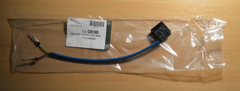

For anyone wishing to go down the OE route, Jaguar now supply the replacement switch through the dealer network as Part Number C2N1908.
It's Jaguar so it's naturally more expensive than sourcing an aftermarket switch but the advantage is it has the correct length leads and terminations with seals.
Attachment 31482
listed at £17.50..still good value over a new door ***

Good value or not I feel the jag replacement is still the same crappy switch design. The Omron one is a better design.
