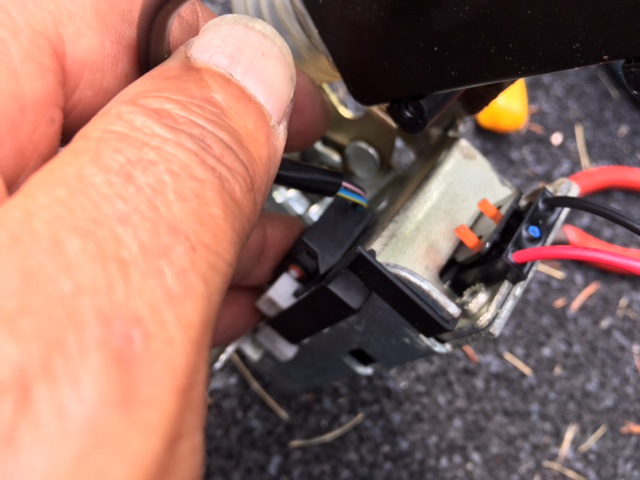

I finally got around to replacing the "Door Closed" micro switch. I was so tired of staring at the perpetual red dashboard light and not being able to lock the car. The combination of Reverend Sam's video and Gus' repair instructions are essential to tackling this job. Here I provide additional instructions to both that fill in some gaps.
NOTE: Do not start this project until you acquire the tiny nuts & bolts to attach your new switch to the latch. (See my comments 3 & 4 to Gus' instructions below)
Watch Reverend Sam's video on how to get the door latch out & back into the car and THEN read my notes.
1. Before disconnecting the battery, lower the window about an inch to make getting the window rail out much easier. Then raise the window all the way up (to give you the clearance you'll need to get the latch mechanism out. "Now" disconnect the battery. Remember to do this in reverse during re-installation.
2. The window rail rides in a slot through the square aluminum block you'll see at the bottom of the window. To get the rail out, once you've removed the 3 screws, just rotate it away from the aluminum block and out of its slot. Don't worry about window re-alignment. The rail goes right back into place. Just don't touch the Allen Adjusting Screw at the bottom of the rail.
3. The window rail does not need to actually come out of the door. Just lay it down inside the door.
4. If you just yank on the actuating rod end to try and get it to pop off of its ball, as Sam said, it will feel like a lot of force, but if you lever it off with a screw driver it pops free with very little drama.
5. When re-installing the latch make sure the actuating arm(s) that hang down are clear of the latch and on the outside of the latch (they will want to hang "inside" of the latch when free).
6. Make sure you reconnect the actuating rod end(s) BEFORE re-installing the window rail. I did a Passenger Door, so I didn't get to address the clip that Reverend Sam broke on the door lock actuating rod.
Here are some extra comments to Gus' excellent piece on replacing the "Door Closed" micro switch. Once again, go over his piece really wel BEFORE reading my notes.
http://www.jagrepair.com/DoorLatchRepair2000xk8.htm
1. The "Stays" that Gus accidentally drilled out are actually nubs on the switch itself (see pic). They keep the switch located on its mount. The switch is held in place only by a springy plate above it that keeps the switch pressed in place on its mount.
2. To remove the switch just pry it up from its mount a bit and slide it out from under the springy plate.
3. Replacement switches do not include these nubs, so you must be prepared to affix the new switch with 1/16" (or smaller?) little screws and nuts, as you can see in one of Gus' photos.
4. I was caught unaware of this and after going through the entire removal processes I wasn't too keen on the idea of putting it all back together just to get those screws, so I looked for an alternative solution. It turns out that my Weed-Eater cord, with its ribbed cross section was perfect. I was able to tightly wedge the cord into through the holes in the mount and the switch, and I left enough cord sticking out of the springy plate to facilitate future removal if necessary. They're not going anywhere and the switch is actually much more secure than the original (see pic).
5. After buying your replacement switch, root around for what will go through its little holes and that you will use to attach it BEFORE attempting this job.
6. Before installing your new switch put it next to the OEM switch and bend the thin metal actuating lever to match that of the original. If you do not do this, it is possible that the latch mechanism will not move the switch's lever enough to actuate the switch.
7. Your replacement switch will come with three wires. Note Gus' multimeter photos. The switch is "Closed" when the door is unlatched. If your replacement switch comes with wires attached (like mine), identify which wire is correct and cut the other one off.
BTW: Many folks recommend spraying WD40 up and around the latch to clear this problem (Door stuck open annunciation). Once you take the latch out of your car and play with it a bit to see how the latch's mechanisms and the switch work, you'll realize that the WD40 won't do a thing. "If" perchance, some time after spraying the WD around, the problem goes away, it's only because the switch is working intermittently and just coincidentally started working again. Mine did this for a few years until the switch failed completely. I haven't cut it open yet to access the actual failure mode, but essentially it is mechanically jammed in the "Door Open" position - the little button will not move at all.
Ahhhh, .... no more red light, no more managing the interior lights, and so nice to be able to lock my car again!
