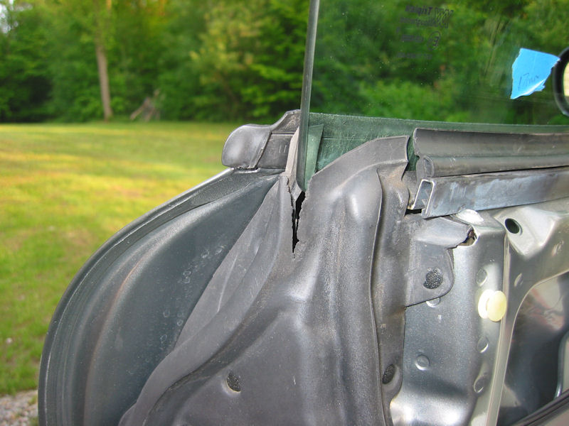

However, I've found that the problem is that the lower back corner of the window is moving down and back when the window initially opens, and is binding on the rubber on the rear window. Using the bolt to adjust it doesn't seem to make much difference to the gap in this area (it seems to be the 'pivot point).
This seems to have been happening for a while - the window/door rubber is damaged in this area (see attached). Anyone seen this before, and have an idea of what needs adjusting?
I have checked the (working) passenger side, and the glass also seems to move back at the same time as it goes down, but it doesn't bind, so I guess it is normal for it to move back.
I have confirmed this binding is definitely the problem. If I open the door, but push the latch fully in (fooling the door into thinking it is closed), then the glass goes up and down about 18mm when pulling the handle - a lot more than it does when closed, and this also matches the passenger side.
Also, when the window goes up (from fully open) I think it's binding on the rear window rubber; it's almost as if the whole window is very slightly too far 'in'.
