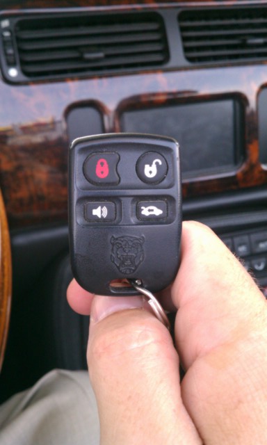

Here's a pic of my key fob. It's a speaker, not a light. However I just tried it and pushing the button causes the headlights to turn on. I didn't know it did that!

Cool...as long as it flips on the headlights you should be fine. Looks like you have a 'special edition' remote. The trunk symbol is also different.

I think what you may have is a Jag remote with a Ford replacement button panel. I have seen this before.
