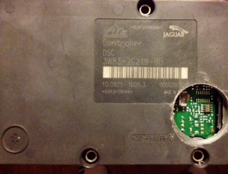

I'm afraid there is a difference. Just pulled the ABS unit to check the solder, drilled the hole and VOILA, nothing. I'm afraid that the boards are different and solder isn't the problem. I'll see if there's a way to get it bench tested around here. Crap.
Thanks for the advice. I can't find any numbering on the plug.
Attached Thumbnails DSC/ABS/No Cruise No Speedo-photo_1.jpg   DSC/ABS/No Cruise No Speedo-photo_2.jpg
