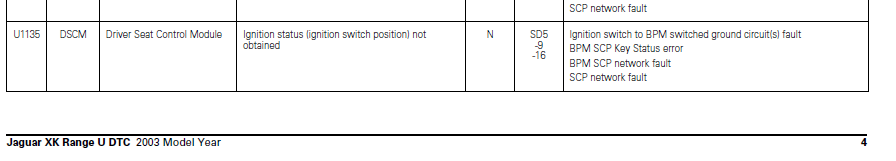

JagNoir, according to the JTIS the code you posted for a 2003 XK8. U1135, relates not to the DSC (stability control) but rather to the driver's seat control module and/or the driver's door control module.
From your description of the momentary flashing of the DSC light but NO reported code I'd bet that's a circuit test and not a true fault since it occurs ONLY at start-up. As for the U1135 code have you ever had trouble with either the seat controls, the door controls, or the memory settings for 2 different drivers that are mounted on the driver's door?

Ah, so allegedly the DSCM is not obtaining valid data on ignition status. As long as everything works, I can live with that. In any case, totally unrelated to the DSC warning.
Getting the JTIS to work (on Windows7) is on my to-do list for today - or rather, getting the links to the technical files (pdfs, I believe) to work from within JTIS. Looks like then I will be able to interpret my own codes
