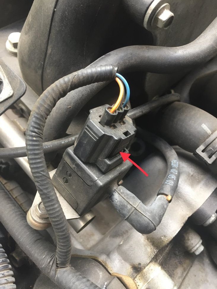

Hi Guys,
Can somebody tell me how to disconnect this connector ?
This is the fuel pressure sensor. I'm getting a P0193 code pretty consistently. I've changed the fuel filter recently, run some Techron through it and I always use premium gas with detergents in it - so I'm thinking this sensor may be the culprit. As with most jobs, for me anyway, the connectors are the hardest part. Of course it is old plastic and I'd rather not force it and break whatever holds the thing on. I tried squeezing at the bottom with no luck. There is a rectangular opening in the top, maybe that is the trick ? TIA.

I have replaced this sensor before, and the connector did not fight me back. 10 min job (my sensor was leaking gas).

Thanks much Fred. I have been scouring the threads and saw many of your posts, and really appreciate the advice. On the connector,
I found a video - of course. The guy just squeezes it at the bottom and it comes right off. I guess I'm just getting feeble !

You should just need to push on the tab and pull strait up.
Might be full of dirt and stuck though, you can use a small screwdriver between the sensor and connector to gently pry while you have the tab pushed in and released.

Thanks Charlie. I'm an expert now. I was pushing on the bar at the bottom (too low). It's always the little things.

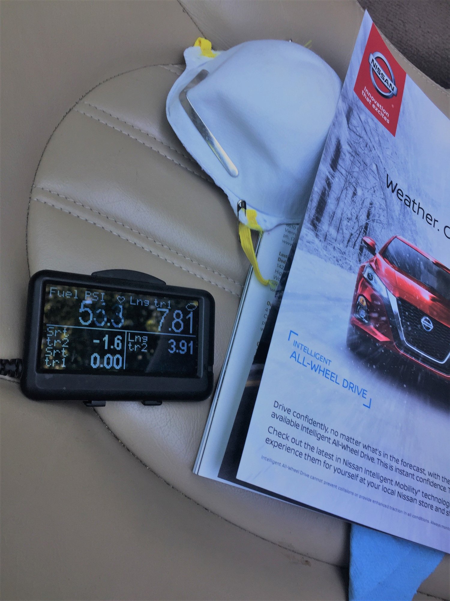

I thought I should report back on the P0193 I was getting. I hooked up my UltraGauge (OBDII reader) and set it to display fuel pressure and the 4 fuel trims and drove the car for a couple of days like that. The fuel pressure would usually stay around 54 - 56 PSI, but at times it would spike to 70 and drop to 35 or so, and when this happened I could feel the car surging and eventually it would throw the P0193 again. So, not wanting to think about pulling the tank and putting in a new fuel pump, I ordered a new fuel pressure regulator. It was a Eurospare for about $50. This did the trick. Now fuel pressure stays between ~54 - ~56, and usually around 55.
Not a real good photo, but it reads 55.3 for fuel pressure. The others are fuel trims. Of course the obligatory mask !
