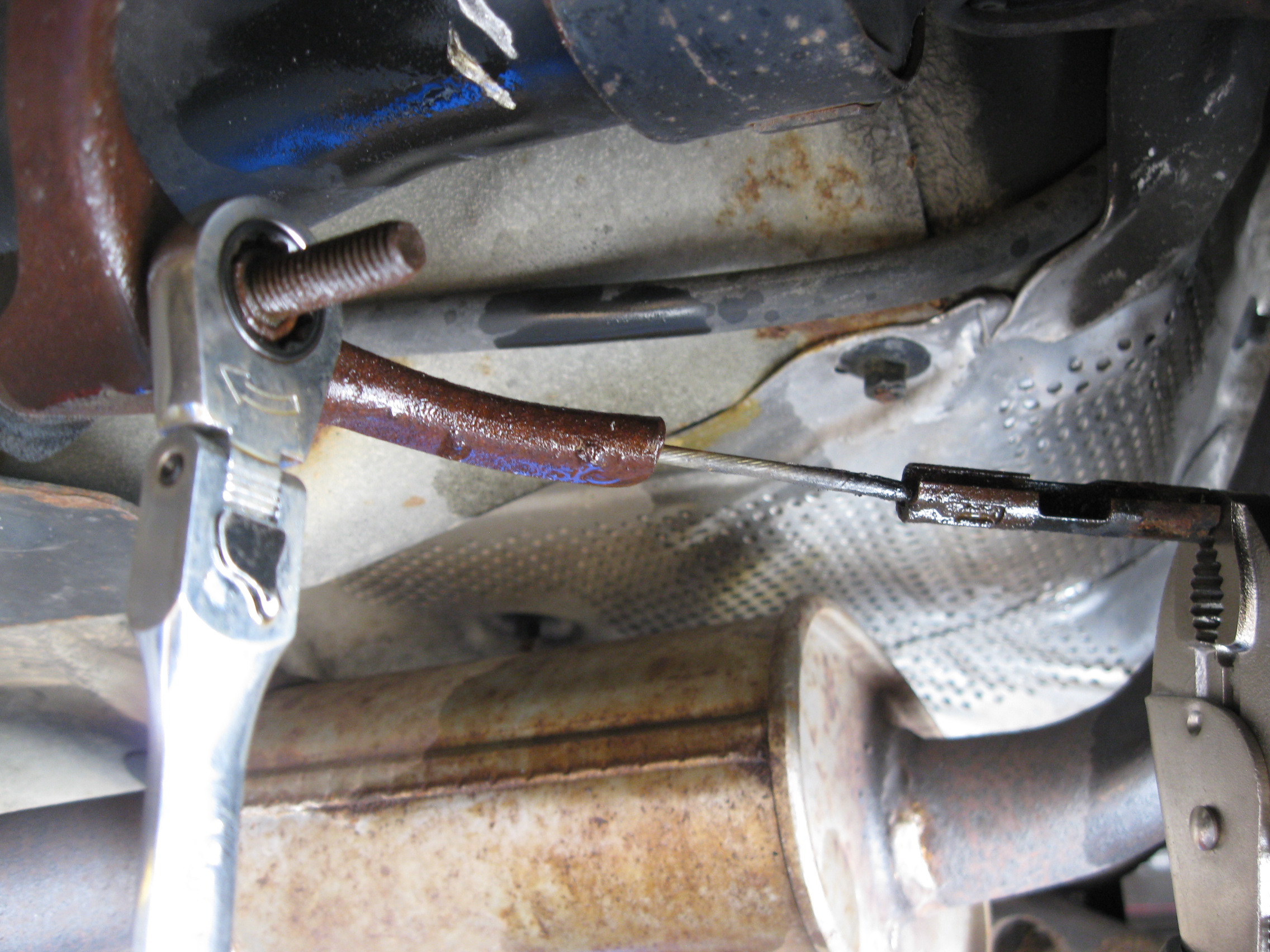

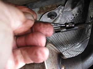

Gus, your photo was the key. For the next guy:
This clip is a PIA. There is an open channel on the top. On the bottom, there is a tab which protrudes into the channel. This tab obstructs movement of the ferrule on the end of the cable.
Even if you get a small flat blade screw driver in there to release the tab, have WD40 ready. The ferrule doesn't exactly slide in the channel without lots (and lots) of help. You may have to widen the channel a bit, and you are sure to need pliers to grasp the clip in 1 hand, and to push the cable with the other hand.
Oh yes, in case you wonder - once you remove the C clip, the grommet can be levered through the chassis. I used extra long long nose pliers.
