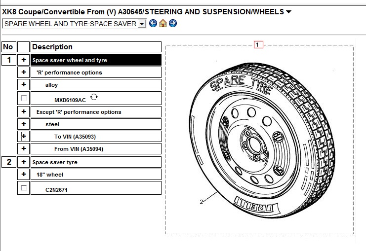

Old Nov 25, 2012 | 01:11 PM
Originally Posted by Spurlee
What's with that red wheel!
It's the alloy Space Saver spare wheel supplied with 'R' performance spec vehicles on 20" wheels. Vehicles with 18" wheels have a black steel Space Saver.
The steel wheels retain the recommended pressure for long periods but the alloy wheels seem to drop 5 psi or more in a few weeks. Worth regular checks for anyone who has this type.
