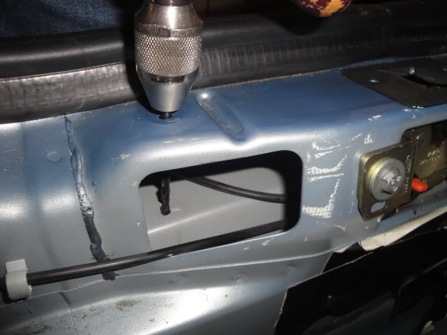

My approach is to start by drilling a hole as shown in this photo, using the fir tree clip hole already present in the top surface as guide for the drill.

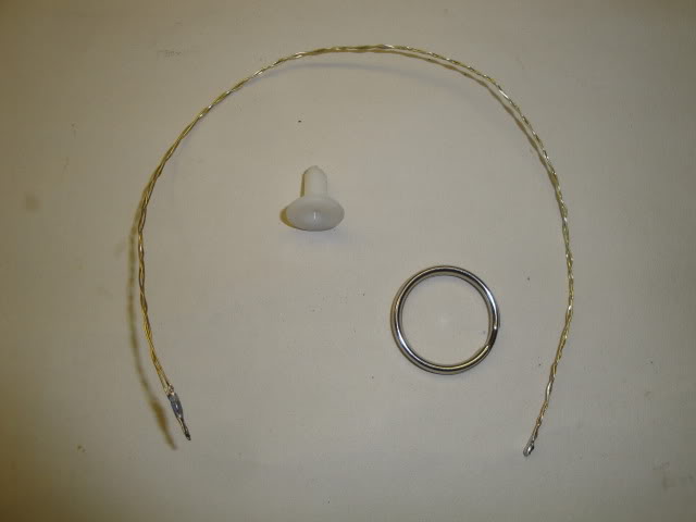

I then raided the come-in-handy box of plastic oddments to find a suitable bush to suit my 5mm hole - size is not critical! - and added it to my other necessary parts shown here - -
That's a split ring, a length - about 300mm - of flexible wire, (or string!) and the bush - again not actually essential!

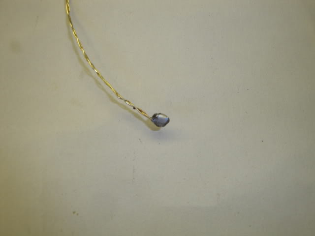

The wire needs to have some sort of 'stopper' on its end; I used a tight loop filled with solder, but a knot in the piece of string would do, as you'll see soon!

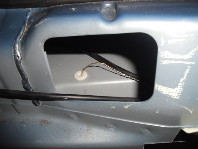

Then through the bush:
And then, from underneath, attach the split ring - or whatever you fancy! - and the job is done.
