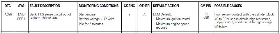

To get you started, here's what the DTC list says about the P0328 code:
If you've had the sensor replaced, then look at the connectors and wiring related to it. The connectors on the V8 are around the thermostat tower area: not certain if that's true for the V6.
Note that the sensor part #s appear to be VIN-dependent - could the wrong one have been fitted?
Check F57 (10A) in the Rear Power Distribution Box for the LH tail light; it powers side/stop//fog on that side. Not related to the knock sensor, though.
