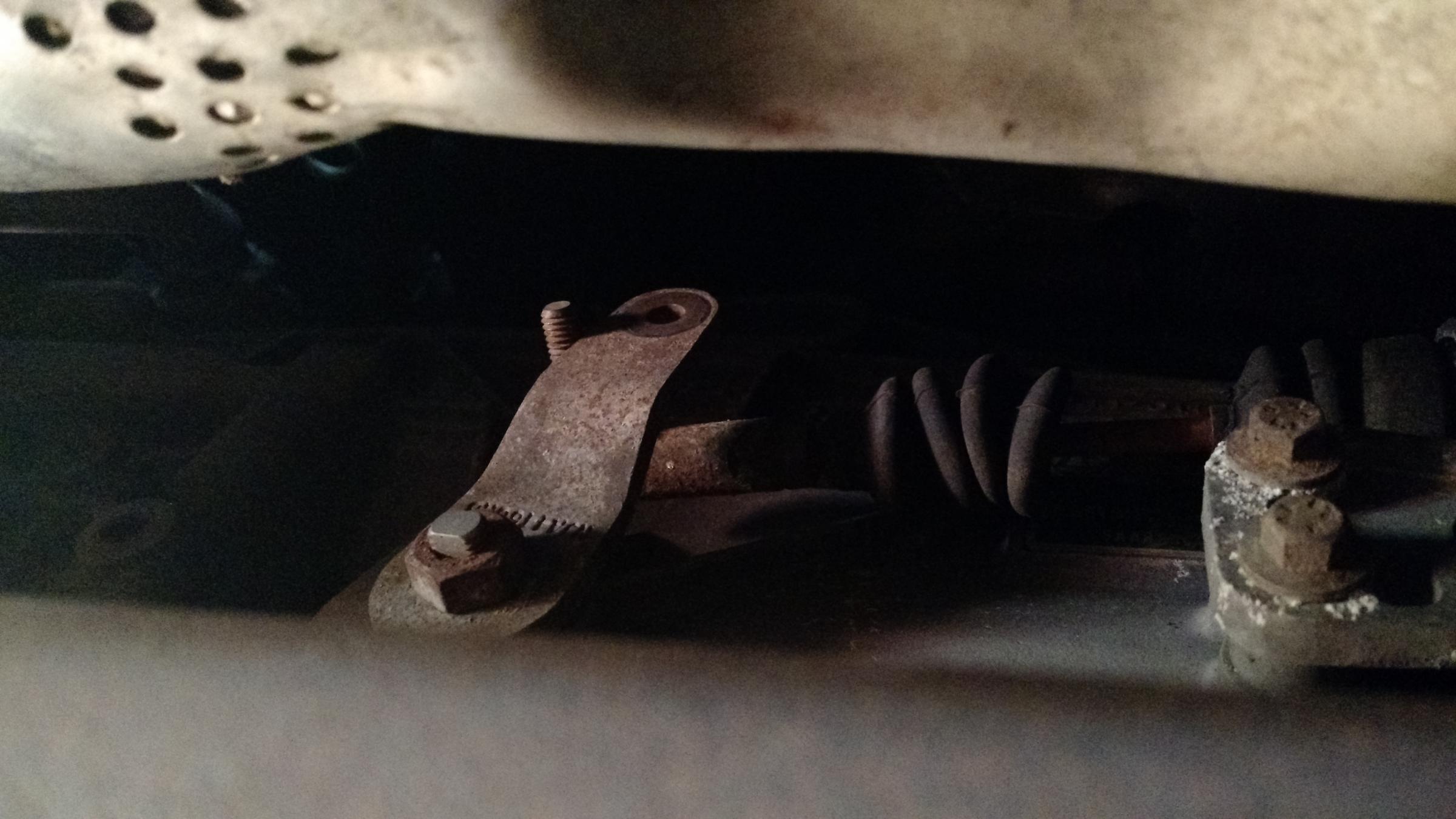

Next moved onto gear selector cable. Not really sure how adjustments this. Could see anyway to adjust at the J-Gate. Below on the drivers side of the trans is the selector. There is a rubber boot there and it connects to an arm on the drivers side of the trans. There was a connector with a nut and the assembly looked a little rusty so it doesn't look like it moved at all, unless it stretched and needs to be tightened a little.

Adjustment procedure for gear selector cable I used is (differs slightly from instructions I found in regard to nut tightening sequence);
1) Place car in Neutral at J-Gate.
2) Remove Center Console and Trim Panels to access the two nuts that hold the cable in the bracket.
3) Loosen nuts and move nuts to end of threads in each direction.
4) Raise car to access gear selector lever on drivers side of transmission. (LHD)
5) Remove connecting link to gear selector lever (10mm socket).
6) Pull transmission selector lever fully rearward which would put it in Park.
7) Ease lever forward 2 positions which is Neutral.
8) Replace connecting link and hand tighten nut, ensure shifter at J-Gate is still in Neutral.
9) Hand tighten nuts at J-gate till each nut touches bracket, then fully tighten nuts.
10) Move to Gear Shifter to Park then finish tightening nut on connecting link. (reason I did this is if you tighten connecting link nut fully before tightening nuts at J-gate, the transmission arm may move when tightening connecting link nut and you get to start over)
11) Lower car and hopefully start it up, if not then rotary switch may be bad.
I attached a couple of pics, first is of the J-gate area and circled the nuts in red. Second is of the gear selector under the car which can be quite difficult as there isn't a lot of room unless you drop the exhaust or can put it up on a proper lift compared to on your back under the car.
