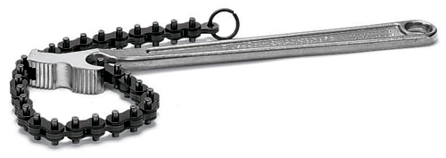

I use a piece of drive belt wrapped around the damper and a CHAIN WRENCH to hold it in place while I remove/install the 24mm hex head bolt.
I have a 24" chain wrench and a 24" Snap-On 1/2" drive Flex-Head ratchet with 24mm socket for just this job.
bob gauff
