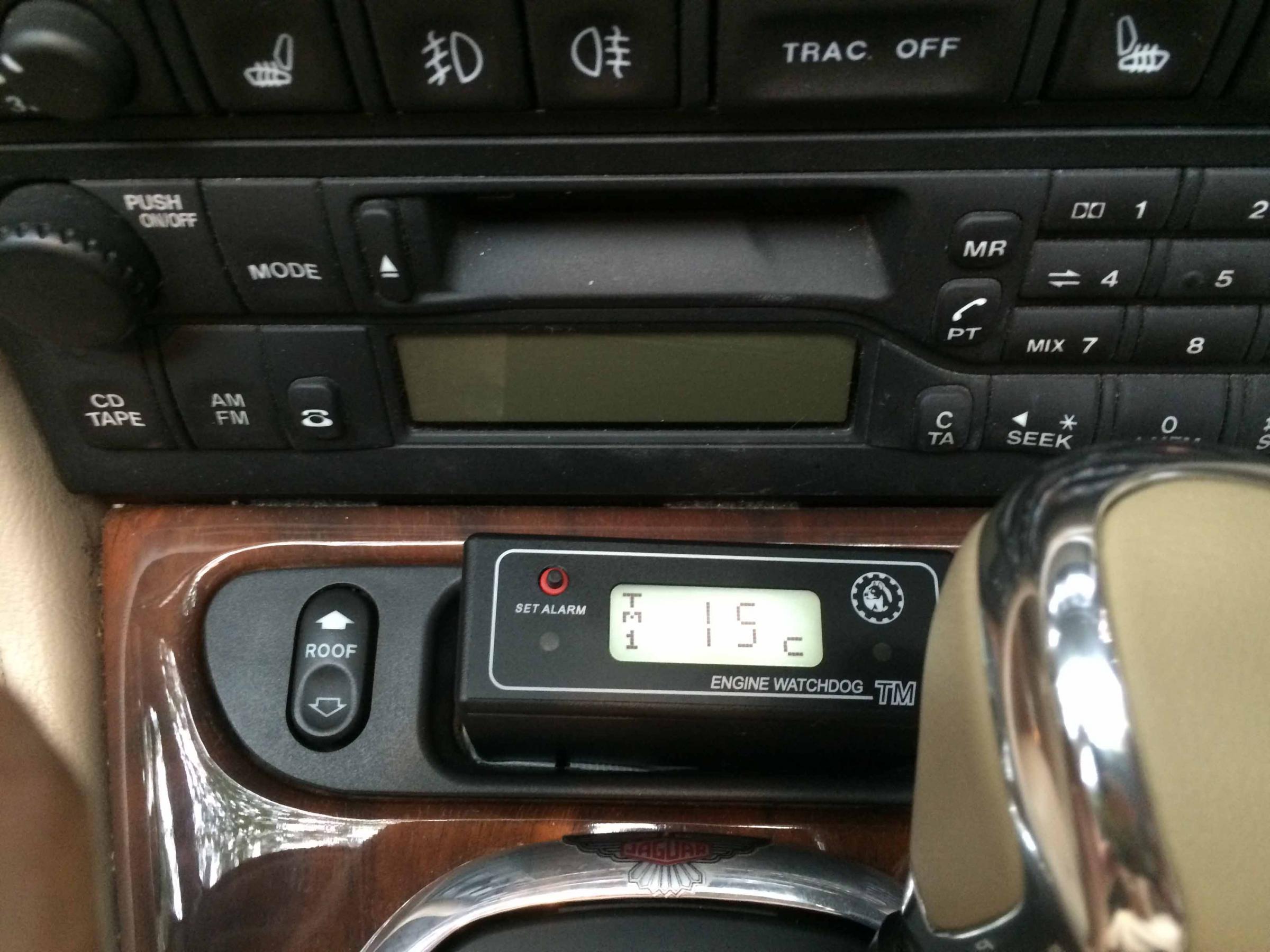

Just fitted one of these (ENGINE WATCHDOG TM2, Engine Overheating Alarm, Gauge & Sensor).
Straightforward - took a couple of hours (would have been quicker if I hadn't need to go to the store for some M5 nuts).
The display fits into the coin tray after I removed the shallow part of the tray floor. - it's a little more proud than I would ideally like but It's really the only place to mount it without being more obvious. I put the sensor on a cam cover bolt.
I'd fretted over how to get the sensor cable from engine bay to cabin and had given up before starting using the JagWrangler method of going via the rubber boot in the ECM bay as in my car I'd need to remove the wipers and screen tray and I reckon I'd still struggle. So instead I routed it via the drivers door and along the upper wing into the engine bay. The only evidence is a short run of cable but when painted black it's nigh on invisible - much easier.
On a stone cold engine the temp is exactly the same as shown by the external temp display which is encouraging. I've not got it warm yet as the rain came just as I was finishing the install.

I agree with you that the Real Gauge is a more elegant solution but TBH I wimped out of buying/installing it. I have fitted a 3-Guage conversion and am really pleased but I had a number of "problems" with fitting which was all down to me really and I needed to take the instrument cluster out several times before I got it all working due to a problem with pin alignement - on one occasion I fractured the little retaining clip that holds the bale in place on the yellow multi pin connector and I am very loath to strip it down again let alone dismantle the cluster itself so the TM1 was my girlie woos solution to real time engine temperature monitoring.
There's actually an oil pressure display on the TM1 as well - just need to connect a wire to the oil pressure sender unit - I just can't access it at home but may get it connected the next time car is at the workshop
