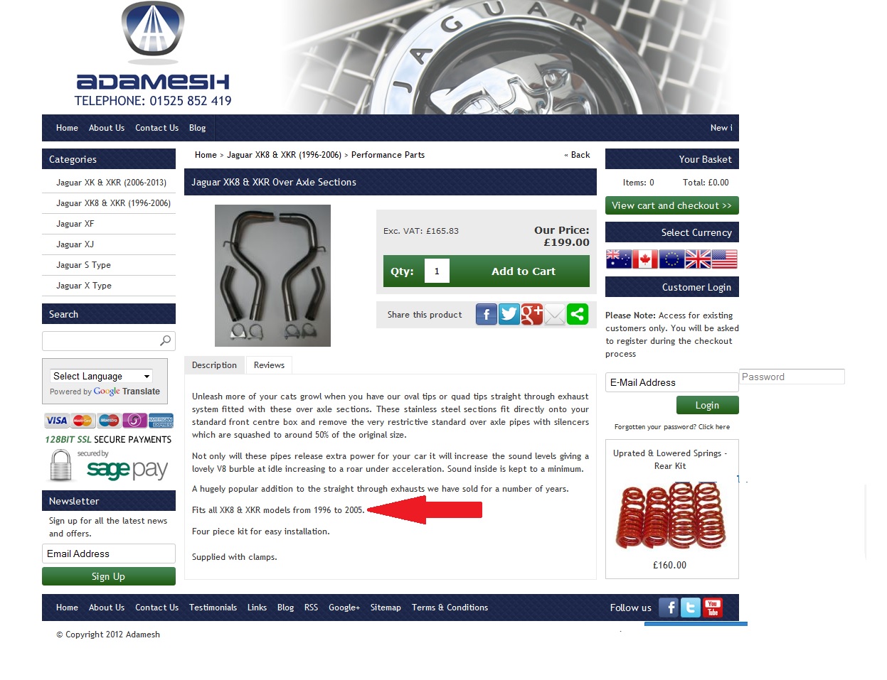

on my xk8 2002 i took off the 2 back boxes and put in adamesh over rear axle pipes,is it exactly the same for a 2003 xkr supercharged car?.........thanks
According to ADAMESH, they fit all XK8 & XKR models from 1996 to 2005.
(see red arrow)
