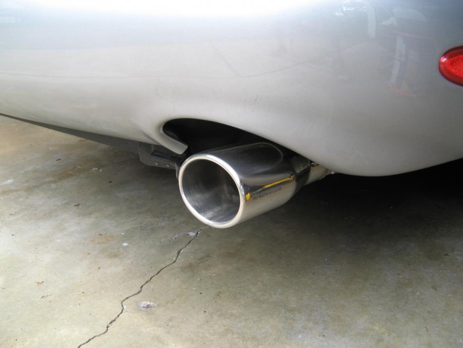

I like the balance and sound from the x pipe,you can get a nice one from Magnaflo for less than $75.I had my local shop cut out the center muffler and weld in the x pipe,I also had them remove the rear mufflers but keep the ones that are in the back side. The sound of the new system is awesome!
