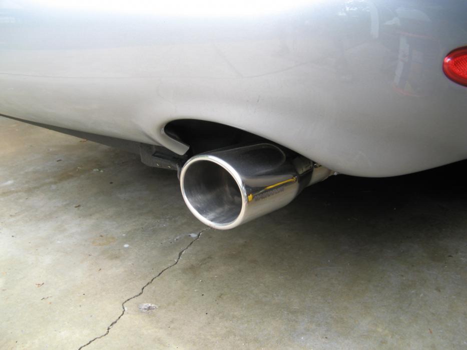

Originally Posted by Fla Steve
What size pipe did you use, and what about that exhaust tip, is that from magnaflow or what brand..looks good.
Sorry for the delay in answering you,been doing year end planning.I used 2.5 inch pipe because thta was the size of the Magnaflow x pipe and reducers to match up with the factory pipes.I went with Magnaflow tips(35158) which were for 2.25 inch but had a reducer welded to where the factory tip was.Hope that helps.

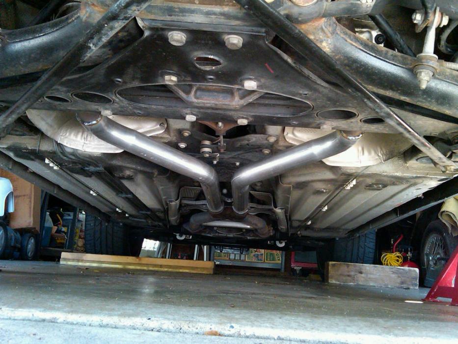

Originally Posted by XK8+XJ8L
Eaglexkr - I had a magnaflow X-pipe installed, but left the other 4 factory cans in the system. I really don't like it much: Not much louder and it has a drone/buzzing sound around 1500 - 2000 RPM. Do you get that having removed the cans forward of the axle? Did you have new pipes made to go over the axles? I wonder if there's much difference between what you've done and using Flowmasters. It's too bad one can't really hear what an exhaust system will sound like until after it is installed. On-line videos just don't do it for me.
I'm trying to find a good solution without springing for the whole MacLeod deal. I'd like it to sound more civilized than my solid-lifter Corvette LT-1 (which my wife doesn't even like to ride in) but I don't want it to be too wimpy. The Mina system is probably good, but I just don't like the looks of their tips. I really prefer having an oval with a rolled edge. It looks like Mina's tips are welded on and close to the mufflers so it would be a hassle to change them. Sigh - someday I'll find the right setup.
I removed all the boxes in front of the axel and just have the x pipe.I ran the pipe into the factory pipe just before it goes over the axel,we did that to maintain back pressure and not have fault codes.This will give your cat plenty of roar,plus if you don't like it you can put the factory system back.Give it a try! Take a look at my photos and you can see where we removed the mufflers and replaced them with the x pipe.

Guys,
I went with the 2.5" x pipe because that was what Matt went with.But according to the shop people,I could have used a 2.25". Like Matts install,they just welded on reducers.
I am still very happy with the result and can't wait till it the end of April when I can get the car out of storage.
Dale,
If I had not added the tips,my cost would have been close to yours,but I went with a nice set of Magnaflow weld on tips.
