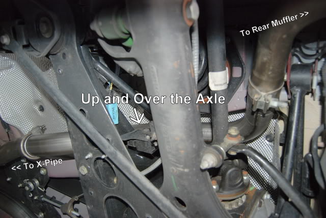

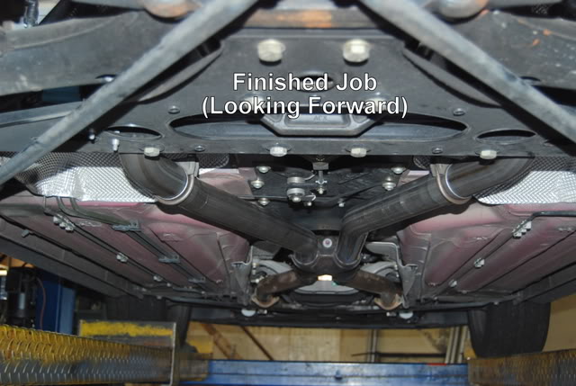

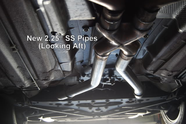

Anyway, here are a few shots with very cryptic notes:
BEFORE:
LOOKING UP:
That's all for now. It's late.

The final configuration is: Stock cats, 2.25 inch Magnaflow X-pipe, 2.25 inch mandrel-bent pipes from the X-pipe back over the axle to the stock rear mufflers. The rear muffler is the only one in the stream. Take a look at the pictures below.

That looks a proper job....well done
and yes the most rear boxes are just resonators, cut the rear pipe off the box back far enough you can see right through it.

XK8+XJ8, I hate to seem critical, but I sure wish your exhaust guy had made both sides of the exhaust symmetrical. It doesn't make an difference as far as performance goes, and it's completely invisible unless the car is up on a lift, but if it was my car it would drive me crazy knowing that the bends didn't match up. On the other hand, I love the bends over the axle. When mine was on the lift the other day I was looking at those factory bends, and the pipes get pinched down to about half of their normal size! I'm going to have either the mufflers in front of the axle or behind the axle removed at some point, and when I do, I'll have new pipes installed over the axles like your's.
One other thing... are you sure he used stainless? The guy who made my X-pipe used aluminized steel and your pipes look a lot like my pipes. the guy who did mine told me that it would have cost two or three times as much in stainless steel.
Old Mar 27, 2011 | 11:44 AM
  #94
XK8+XJ8L's Avatar
Posts: 533
Likes: 45
From: Bellevue, WA
Sam - Regarding the asymmetry, I wasn't out there watching him, so I didn't see it till the job was done. There is a lever mechanism on the left side that the pipe has to miss (you can kind of see it on the 2nd and 3rd pictures), so that's why the bend is so far forward on that side. I guess he could have made the right side look the same, but it doesn't really make any difference to me, so I blew it off. If that was the biggest imperfection in my life, I'd be grateful.
Yes, they are stainless. The difference was just material costs. Aluminized was like $6 per foot and SS was $12, so it added $90 or $100 to the total.
Another point of interest: The existing pipes are actually 2.125 (or whatever the metric equivalent is). Since I wanted it to fit up to the existing slip joint near the rear resonator, he squzz the end of the 2.25 section down to 2.125 at that point.
