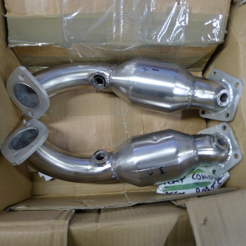

As you can see from the photo below the CAT was replaced by a stainless one. Only time will tell if its better than the original structure wise.
David an interesting thread. My problem was not getting another exhaust but the noise factor. The actual exhaust on there is solid but I do not like rust and there is plenty of rust on my exhaust, and yes its the original SS one. Ok no one will ever see it, apart from the garage and myself, but I do like to do things to the best of my limited abilities.
The photo below is obviously before the new CATs were fitted.

As I mentioned earlier, I replaced my Exhaust System with the Quicksilver Heritage Sport System several years ago. It's a Cat Back system and really looked good new. I continued to use the Stock Cats as the Right one had not burned out at that time.....If I had known it was going, I would have replaced both with Cats like yours! The ones like your new ones are really nice and breath much better than the old Stock ones...I don't have a friend with a Lift like you so I have to use my mechanics equipment and thank Heaven, he had an old Right side Cat laying around and he let me use it. When we finished the job it really looked good, all shiny and Silver and the sound was somewhat loader, which I like anyway....I really like the sound and the looks as it is S/S. Some where along the way I hit something in the Road and knocked a hole in the Big Muffler in the middle, which I had patched...but that looked bad, so when I hit something else a few months later, I replaced it with a Magnaflow 4 Pipe...It was nice and shiny but that doesn't last long.....I like the system's sound better now but it's half S/S and Half ***.....as you can imagine!
