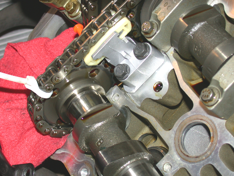

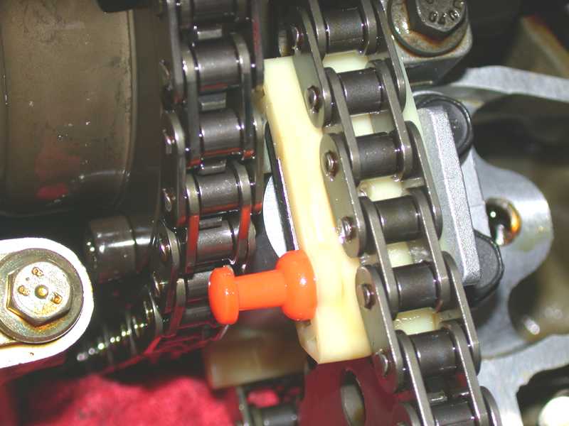

Hello to one and all. Thought I would share my experience with pics of replacing the 2nd generation cam chain tensioners with the new metal tensioners the third generation. This thread is in support of "2nd tensions DIY instructions FAQ" by sininnellen. Therefore I will not repeat those instructions. This thread is also in two parts due to the number of pics. The first part, this part, is mostly for the purpost of showing the pics of the inside where the parts are replaced. The second thread will show pics and discuss the problems I ran into with solutions.
The first three pics are of the right bank. First pic shows what it looked like initially but with the tie wrap installed on the exhaust cam sprocket and chain. This is with the 2nd generation tensioner still installed.
The next two pics show the new metal 3rd generation installed both front and rear view with the tie wrap still installed. Don't forget to remove the tie wrap.
The next set of pics are of the left bank with the first three showing the as was installation, 2nd generation still in place. The next two show the new metal version installed both fore and aft. These last two also show a shop rag jammed in the big hole up there. I thought that was a good idea to avoid any parts falling down the big hole. I did that on both sides. Removing the old tensioners is not a concern here in that they stay in one piece due to the oil in the piston causing a suction that keeps them from falling apart. But, on the right bank you have to remove the red safety pin that holds the new tensioner together before you can install it. Therefore you have to hold it together as you place it. On the left bank you can leave the red pin in place as it is installed. See next to last pic. Just don't forget to remove it. Also the new tensioners are different left to right. They are labeled LB and RB.
To do this job you have to undo the exhaust cam as covered in the FAQ. I will not repeat those instructions except to add that the cam wants to roll down hill when lifted up for tensioner replacement. It will put a twisting load on the cam chain. I anticipated this and put one of the cam cap bolts back in the lower most aft location. This gave the aft end of the cam something to rest on which kept it from trying to twist the chain.
The last pic is the only one that shows the cam caps removed. Also the first pic of the left bank shows a tie wrap holding the oil dip stick out of the way. That worked good.
The torque values for the tensioners and cam caps are 14 and 11 nm respectively.
That is all for this thread. I will continue on with more pics and discussion in the second thread.

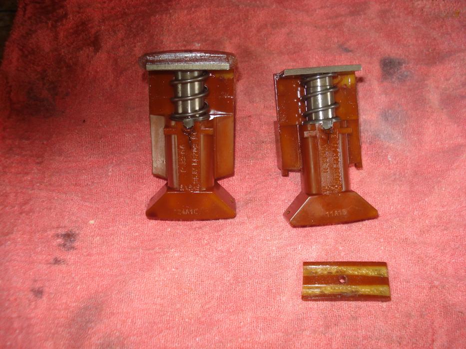

The next picture shows the comparision of the new metal tensioner with the big plastic tensioner. Quite a difference in size.
The next picture shows the two removed plastic tensioners.
At first I thought they looked pretty good and probably would have kept on cooking. But after a close look as you get in the last picture cracks were starting just above the notch cut out at the bottom of the barrel. As you can see in the picture the cut out has sharp corners that cause stress consentration in that area which in turn causes fatigue cracking.
That is exactly what is happening. These upper tensioners are subject to side load especially during engine start up. Why the notch cut out? I don't know but it sure was a stupid idea and probably ruined a good part.

Originally Posted by EZDriver
But after a close look as you get in the last picture cracks were starting just above the notch cut out at the bottom of the barrel. As you can see in the picture the cut out has sharp corners that cause stress consentration in that area which in turn causes fatigue cracking. That is exactly what is happening.
There is more than one picture showing the *exact* same crack at the same angles and start points.
Yes, there is also a longitudinal groove in the sleeve at the same point. More stress at the plastic key that fits in the groove. Then there is all the effort expended on making voids in the plastic, and not bringing the sides of the barrel all the way to the edge for greater support
It is actually a nicer design than the newer part. In metal, it would have been bulletproof.
A cad program is one thing, but if some junior engineer had taken a 8 ounce hammer and smacked the piston foot sideways, they might have figured it out.
How many miles?

I recently had the secondary cam chain tensioner's replaced and wanted to share with everyone pictures of the old tensioners. I drive a 2001 Jaguar XKR Coupe with 90,000 miles. I purchased the car with 72.000 miles. I called the dealer that serviced the car and he confirmed the car still had the original tensioners. The car has run perfectly, so last year I kept debating whether or not to change them. I waited over the winter with the car in storage, but several months ago I read on the forum several drivers with a MY 2001 had theirs changed, I finally bit the bullet and had them changed. Total cost including parts was $980.
The tensioners have the same small crack that the previous pictures show, but what is different about one tensioner was the plastic shoe separated from the top of the tensioner. You can clearly see that the end of the plastic shoe had fractured completely off and was not found on the car. The top of the shoe shows groves from the cam chain passing over and is quite deep.
My point is that I think I avoided the bullet just in time. The shoe could have let go at any time and would have caused havoc to the engine. I think the car was on borrowed time. I am so glad I had it changed before the current year driving season. I plan on driving the car to several JCNA shows this year and certainly did not want to experience trouble with the tensioners. The car is ranked 6th nationally and 2nd in the NC region.

Glad we're all still around to relate our 'near-death' experiences. Here's the two I took out of my '00 with 63k miles on it last week. Whew! Too close for comfort

Wow. Totally cracked. Too bad there is no oil pressure gauge to alert you of a problem like this, IF it works like that. Most oil pumps pump a lot more than the engine really needs and excess oil runs out the bypass.
I guess these tensioners can malfunction in a number of different ways. Mine didn't crack, but threw a shoe, allowing the cam chain to get loose. I believe it caused all the random misfire codes on that bank. I am not worried about it loose in the pan, but I will take the pan off and have a look since I'm still down with the AC compressor.
