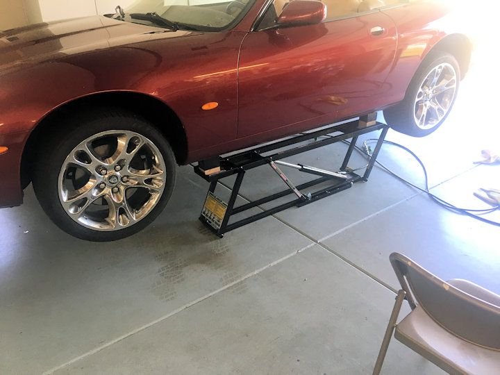

Well, all of a sudden we have this extra time on our hands. A good thing with a Jag is that there are always stuff to fix.......... So, this past weekend up on the QuickJack it went. I like the QuickJack a lot. Only shortcoming is that you only have front and rear access - no side access. But, you get used to it.
Main reason for getting it up in the air again was for new front swaybar bushing. New bushings and new end links. Guess what? The old clonk is now completely gone!! The funny thing is that the old bushing and links looked pretty darn good. It was a pretty easy job. Just a bit tight on the driver side and needed a loooong extension.
While up in the air, I also grease the rear half shafts. Everything felt tight and good.

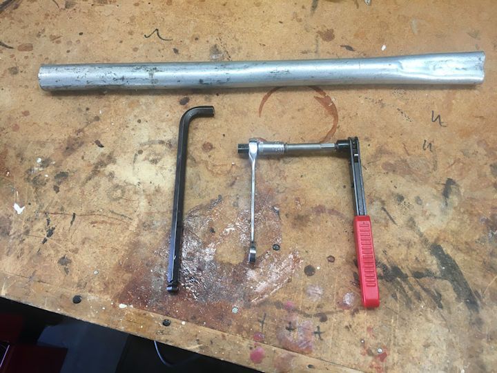

Always worried about the transmission so I have wanted to have a second check on the fluid level after my second fluid change. Now that i have made a special over the exhaust pipe wrench it is so easy - no more burnt fingers

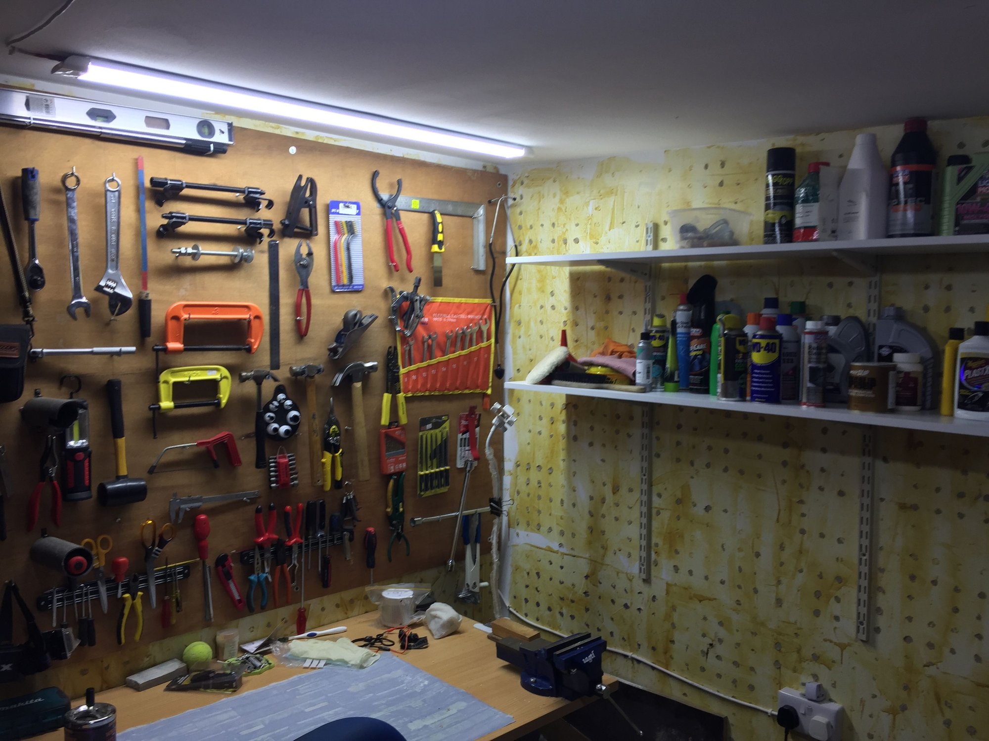

Default Home tool box cleaning and sorting
Quite proud of my AC-ed garage workshop....
but as we all know tools are only good if you have them “at hand” so....
I have a portable tool box for the home.
Decided today to clean the home tool box and try to sort it out. All garage duplicate tools were loaded in the home tool box.
It was was a bit of a surprise what you can dig up in the bottom of drawers and boxes.
Geez... I’ve must have way to much time on my hands..

Default QuickJack
Nalle,
I also have a XK8 (2003) and a QuickJack. I really wasn't sure exactly how to lift it. I actually, bought the QuickJack for my Aston Martin. Anyway, a brief examination of the Jaguar seemed to indicate that I needed the "pinch block" rubber pieces so I ordered them.
Obviously, you have been successful in lifting yours so I am wondering if you mind sharing the specifics so that I am sure to do it right. I currently have the two sets of rubber blocks that came with the lift and then the new set that I ordered that are supposed to be used for a "pinch weld" lift. Your thoughts?
