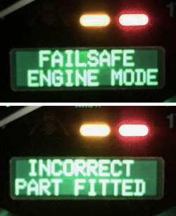

Hi all,
My car had been parked up for 3 weeks outside in fairly wet weather (UK).
When I got round to starting it up I got a message on dash FAILSAFE ENGINE MODE.
I drove it down the road and back and it seems to drive fine.
There was no OBD error codes when I scanned it.
Anyway I decided to disconnect the battery over night and charge it up fully.
Also due to the damp weather I popped the bonnet and sprayed as many of the connectors as I could with WD40 to try and displace any moisture that might have accumulated.
Today whenI started it up I got the same FAILSAFE ENGINE MODE, but then followed by INCORRECT PART FITTED. I've not change or fitted anything!
Does anyone know where I should start looking or what the problem could be?
I have tried several scans but I've got no OBD codes showing up.
Thanks in advance.

Read your codes jot them down and clear them then start the car with a fully charged battery and see if they return. Take the codes and post them so we can see what you have.
The car isn't producing any error codes. When I scan it with the OBD reader there are no stored codes. Its connecting fine and I can monitor everything else as usual.
When I started the car today the battery was FULLY charged and the battery is in good condition.
This is why I'm stuck. If it was producing some OBD error codes I would know where to start looking.

I would try a Hard Reset and see if the gremlins disappear. With moisture and low battery things can go bonkers.

Please see my post from about 2yrs ago on this link. I am happy to says that is still fixed as I type this today.
https://www.jaguarforums.com/forum/x...-fault-112493/
My only regret may be that in the future I did return the TCM that was not needed then.(~$100)
I also had the same two fault messages without throwing any DTC codes

When I first got my car I had the same error message after detailing the engine bay (degreaser + garden hose). All good after I took it out for a drive and dried things out.
These cars are meant to be driven, so sitting for three weeks probably isn't a good thing. A discharged battery alone will cause havoc. The dampness just adds to the problem. You now have the battery fully charged, so I would start it up and let it run for awhile in order to dry things out in the engine bay before throwing any $$$ at it.
If the car is going to be parked outside for extended periods, I would consider getting a solar cell trickle charger that plugs into the cigarette lighter. Even on cloudy days the solar cell will keep on working and keep your battery topped up. Just place the solar cell on the dashboard and plug it in.

I think the WD40 has got into something. It's best not to use it on modern cars (lower voltages and anyway it'll wash out the contact grease).

Hi Guys, I've tried a hard reset buy no joy, still the same messages.
So Im letting it idle now and will take it for a gentle drive to get some heat into it and see if that helps.

Do you know of anyone in your area that has SDD or IDS to read all the codes? I had a problem like this and found it was one on my knock sensors and this was shortly after I washed down the engine. I am not saying that is your problem but knock sensors and water are not compatible. If SDD and IDS system is not available then try plugging in your OBDII reader and drive the car and see if it captures the code then. If it does not use the clear code button on the reader and see if it does anything for you.

Hi all, Just thought I’ve give you all an update.
So I went out for a 30 min drive at the weekend and I couldn’t detect any fault from the way it’s driving. The gearbox is shifting fine, there’s no restriction in revs or speed and full power is still there.
After about 15 minutes of driving the “Incorrect Part Flitted” message went away, but “Failsafe Engine Mode” remained.
The car is still not giving me any OBD codes at all.
I have tried another hard reset but still come’s on with the original error messages (I think before I have even started the car)
One thing I have noticed is when I alarm/disarm the car, there are no beeps from the alarm.
And I probably should have mentioned that the Cruise Control module hasn’t been working for a few years now and always displays “Cruise Control Not Available” however I wouldn’t have thought that would be causing the engine failsafe mode or Incorrect part?
I have a feeling I may need to visit a garage to get this looked at.
Cheers.

Its well documented that a faulty brake switch can cause the cruise control to stop working, and get you lots of error messages into the bargain.
I would look into changing the switch first to see if that makes your failsafe message go away.
Here is the FAQ:
https://www.jaguarforums.com/forum/x...ics-faq-37758/
Read up on how the brake switch(es) works - you will be surprised at what they actually do.
