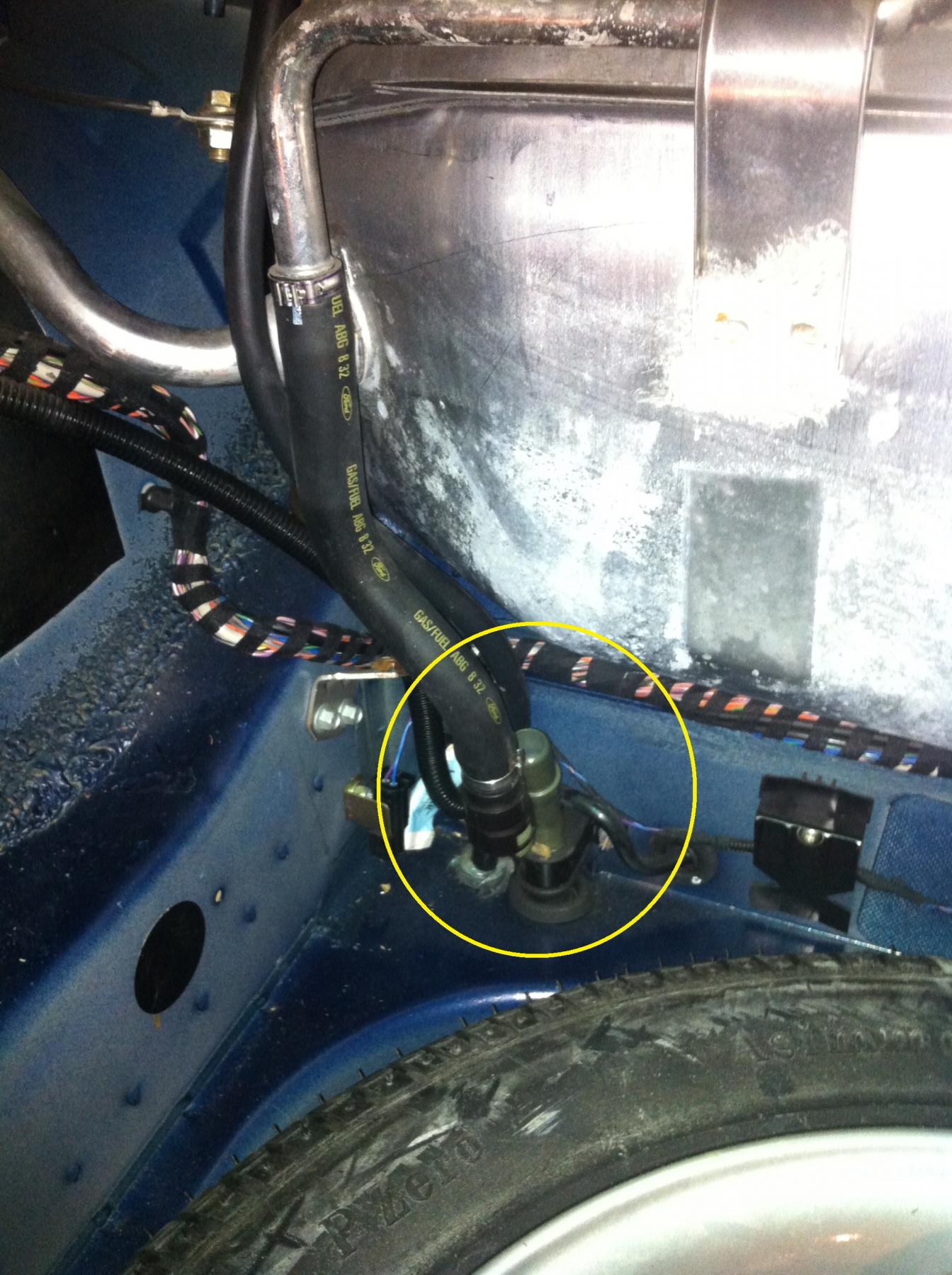

Been having an issue in filling up my XK8. It will stop after short time as i is only filling the neck up. The problem happen a while back but did go away but now has returned with a vengeance. I found the "Cant Fill Gas" thread and read that on up and decided tonight to attempt to figure something out with it. Well, after removing a hose in the trunk behind the fuel cell shield i noticed some pressure release from that area. So, with that off, went to the gas station and "tadaa" I got GAS! ( not me my car did) Now comes my question... what is that hose and what needs to be done to fix that issue. I have attached a pic and circled the affected area. Please let me know what I am looking at and some clues on where to go next.
As always... thank you for your help.
Mike

Yes... I did try to fill with that hose connected back and it instantly stopped filling again. It is an issue with whatever that hose goes to down into my floor of the boot.

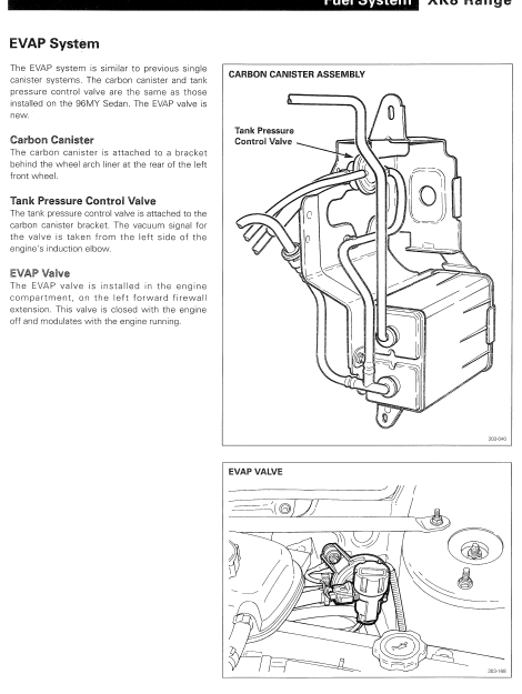

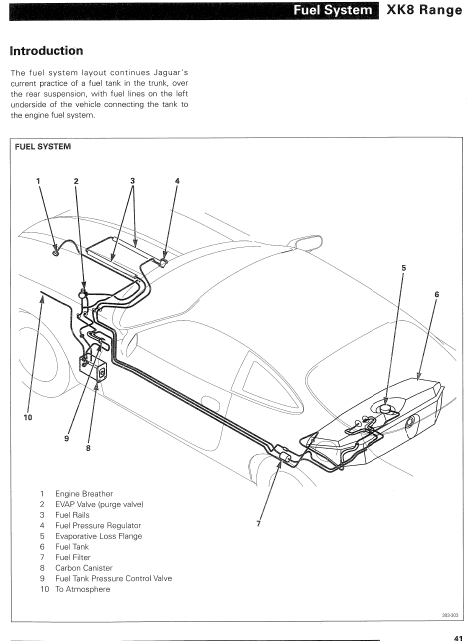

Hi.
As you can see from the attachements it's a fairly complicated system, which, to be honest, I don't understand too much of.
But as far as I can see, it's going a vent hose all the way forward to the left wheelwell.
Attached Thumbnails Filling Gas Problem-fuel-1.png   Filling Gas Problem-fuel-2.png

Hi again.
The JTIS (Jaguar Technical Information Service) contains an extensive fault diagnose with lots of failure codes and what to do.
There are different evaporative systems for different markets. I have a US spec. car with dual carbon canisters.
You may check that the vapour purge hose going from the tank to carbon canister in fwd. left wheelwell is open.
