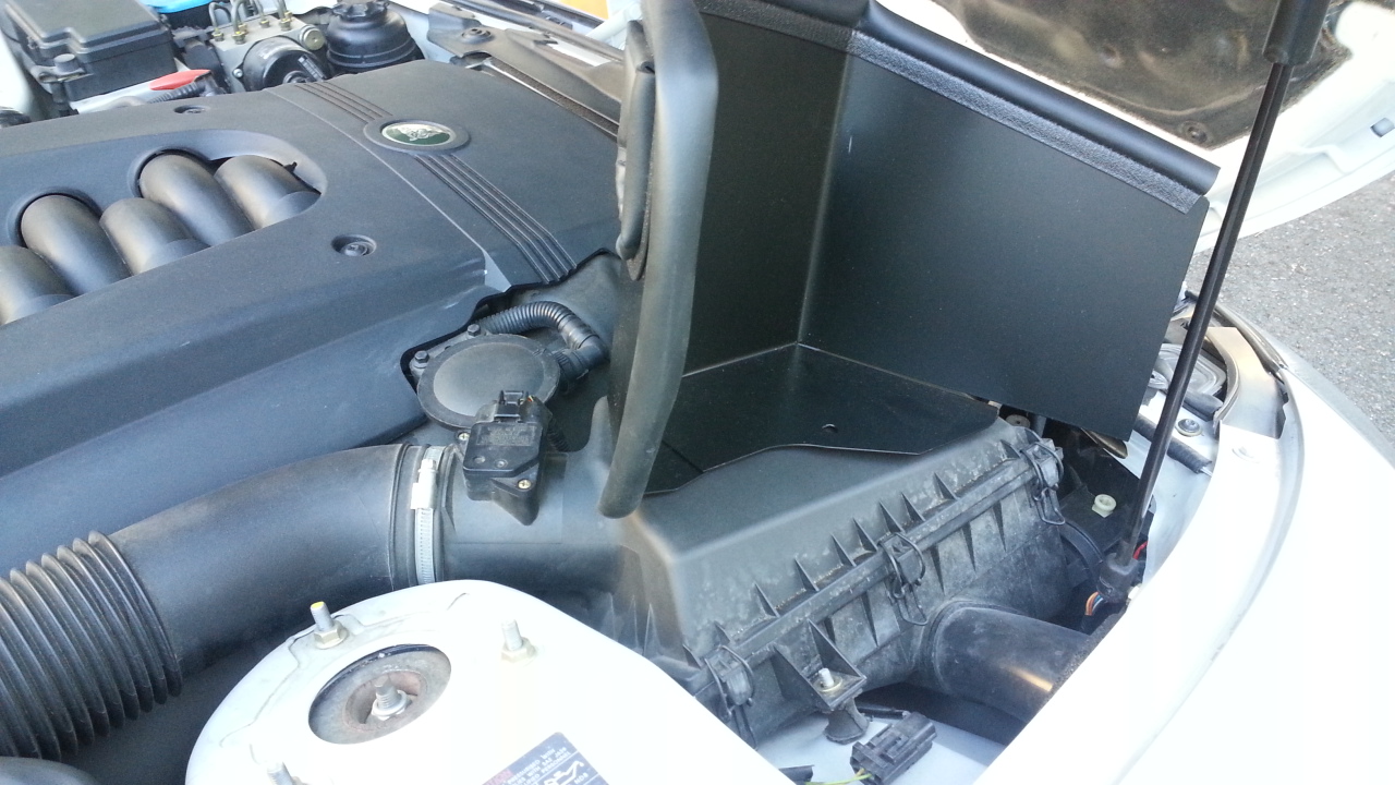

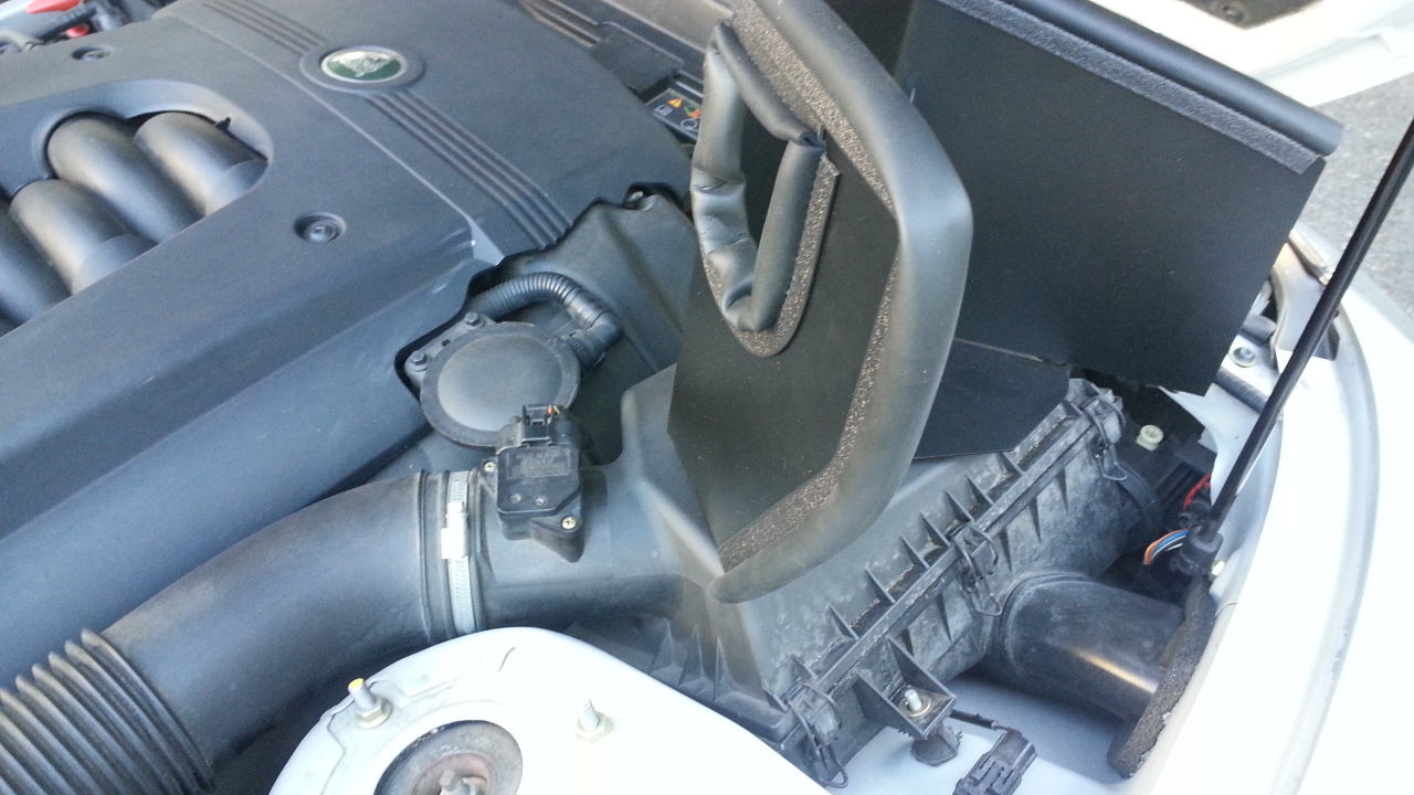

I know it suppose to be simple....but when I put the Mina's intake on top of the stock box....this is what I see (see pictures)
It seems like I have to modify the intake pipe to work with Mina's, am i looking at this wrongly?

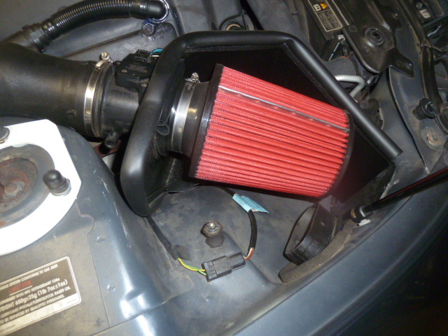

My XK8 is a 2000 model year, so I'm not sure if your car, being 5 years newer, might have a different intake setup. I took some pictures of my installation; not that the rubber mounts holding the OEM air box on to the fender can be a bit of a bugger to get off (see picture of the mount). Beyond that, I would suggest you contact Chris at Mina Gallery and have him walk you through the install (which is what I had to do, because the directions that come with the kit aren't great).
I've purchased several products from Chris, and always found him to be very agreeable to customer service phone calls, as well as having high quality products. Anyway, here are some pictures.
Thx Max, it looks like my box is different that the earlier year box...I'll contact Chris and see what he has to say.

I checked on the Mina website, and you're correct; it's a different setup from 2003 - 2006. Give Chris a call. I found it helpful to call him when I'm at the car with the item in question ready to go. His shop does these installations and he's very well versed on how they get put on.

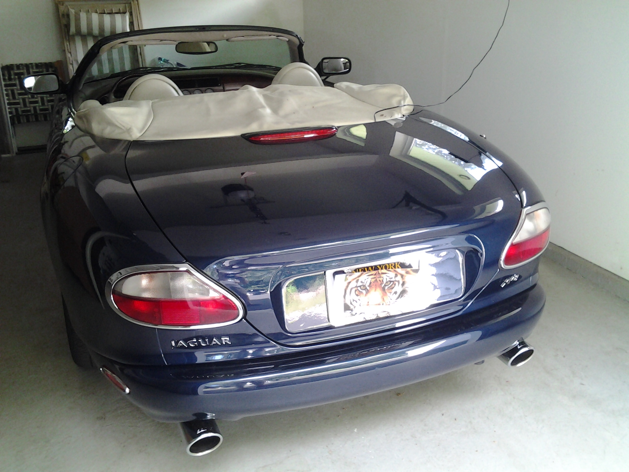

I guess judging the price you paid you are doing the under axle?? system. I did use the mina rear can ( muffler) delete as well as the air intake. I am pleased with both. I did change the chrome extensions over to a wider, 12 inch long tail pipe extension. I like the look and found the wide mouth reduced the exhaust drone. Found removal of old system a snap on my '99 XK8. Little nut buster spray the eve before. loosen bolts, wiggle, wiggle system came apart. Both sound great when you get on the go pedal a bit. Lots of luck with your install. be sure to share the experience. Rich

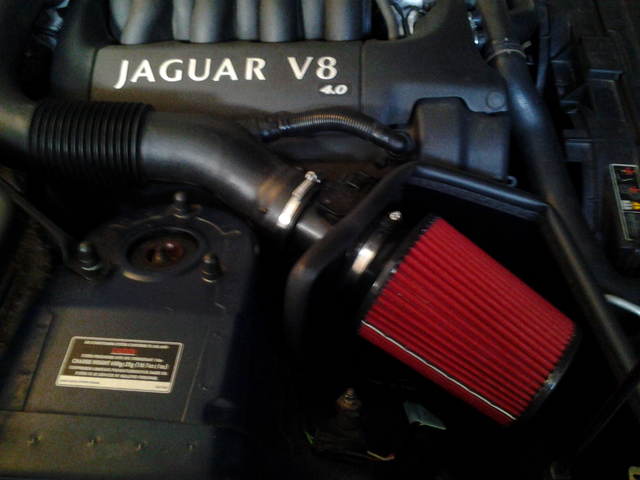

I don't want to burst your bubbles guys but the intake filter is a bit of a swizz (as we say in England!). Look at the pic of the installed new filter ---->
The reason it improves performance is down to the right - the tiny (original) intake duct. Compare its size to the size of the duct by the MAF. The new filter can suck much more air (some of it hot), probably improving throttle response. The 'improved' sound is because it's sucking under the bonnet and not the wing. Now for the depressing bit - chop the end off the standard box below the filter and you'll have EXACTLY the same thing! (Sorry guys).
So you are saying we don't need the intake to achieve the sound and the improved throttle response? we just have to cut the original box a bit and we'll get the same thing?
Old Oct 6, 2015 | 10:50 AM
jimforrest (uk)'s Avatar
Joined: Feb 2015
Posts: 292
Likes: 125
From: Hampshire
Correct. Cut it BELOW the filter panel and remove the original intake spout.
