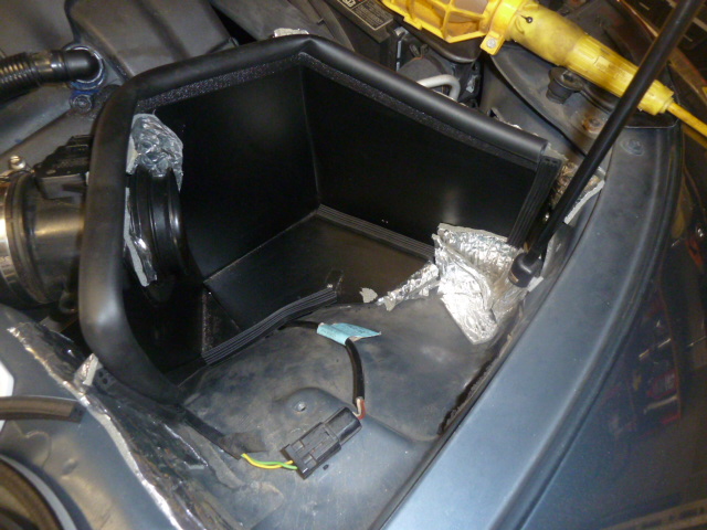

The latest on the air intake project; I spent some time seaing up the gaps in the Mina air box with self-adhesive insulation. I'm considering using an aerosol expanding foam, but am concerned that will make removing the air box to take off the right valve cover a problem. I also removed the "fuzzy" seal around opening in the inner fender, which increased the opening to 5-1/2" x 2-1/2" which roughly increases the intake area by a factor of 3 over the OEM snorkel opening. I let the car idle in my driveway for about 10 minutes, and noticed that the ambient intake air temperature increased, but by a very low rate, and never got over 15 degrees above the outside temperature.
So far, so good; now for the road test! A report and pictures of the air box and fender opening to follow.
The road test was very interesting and, in the absence of any test instruments, also subjective on my part. In "Normal" setting the initial throttle response seemed better, as did the sensation of acceleration when gradually giving it more gas. It still has that slight "hole" under 2,000 rpm if you hit it hard, but that's just a characteristic of the car. The response in "Sport" also felt better, as did the overall acceleration, and the howl between the Mina filter and the exhaust system was great!
There were a lot of small and not-so-small air gaps between the air box and the fender, and I spent this afternoon attempting to plug them with weatherstripping and self-adhesive insulation. The result wasn't pretty (see pictures), and after I drive the car for a bit more, I may end up going with the self-expanding spray insulation foam. Overall, I'm pleased with the result, and how relatively easy it was.
However, computers... I too have a mina exhaust and air filter installed. I have noticed changes in performance after a few hundred miles once the engine computer has adjusted to the new air filter/ exhaust. Kinda like when you do a hard battery reset. I do find the exhaust tones have improved after the computer relearn, ( particularly when cold, open loop), I am not so sure about the air filter. I have been having reduced performance here and again. Some on this site have stated they too have had some problems with the change air induction. Too much air?? I do love the sound on part to up throttle. I am trying items, filter covers and the sure to have a happy medium. Will let you know the results. Good luck to you as wll. Rich

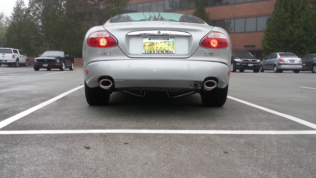

My Mina exhaust sounds much better now after a week...I do feel that combined with the intake sound I am pretty happy with it.... no x-pipe needed.
The only downside of the Mina exhaust is that it's pertruding when looking from behind the car (Yea I know I am missing a tow eye cover) I already have it but trying to find option of spending $200 to paint it or just plastidip it)
