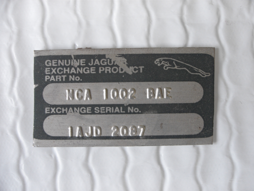

How do you know if you have a Nikasil or steel-sleeved engine. The engine number may give you a production date but that may not be relevant to the build date of the car. Many early Nikasil engines were recalled by Jaguar and rebuilt with steel liners and I suspect the engine number wasn't changed on the block. In theory, there will be a tag like this :
but mine was in the 'owners pack' rather than still stuck to the engine.
Personal opinion but - if your original engine is still going strong, it doesn't much matter if it is Nikasil or non-Nikasil ……………. high-sulphur petrol (gas) is long gone so it isn't really an issue any more !!
The engine number in mine (971105 nn:nn) is appropriate for the build date of the car but wasn't fitted until 2004. Other than the reman label I don't think there's any way of telling by inspection.
I'd have no worries today about a Nikasil block.
