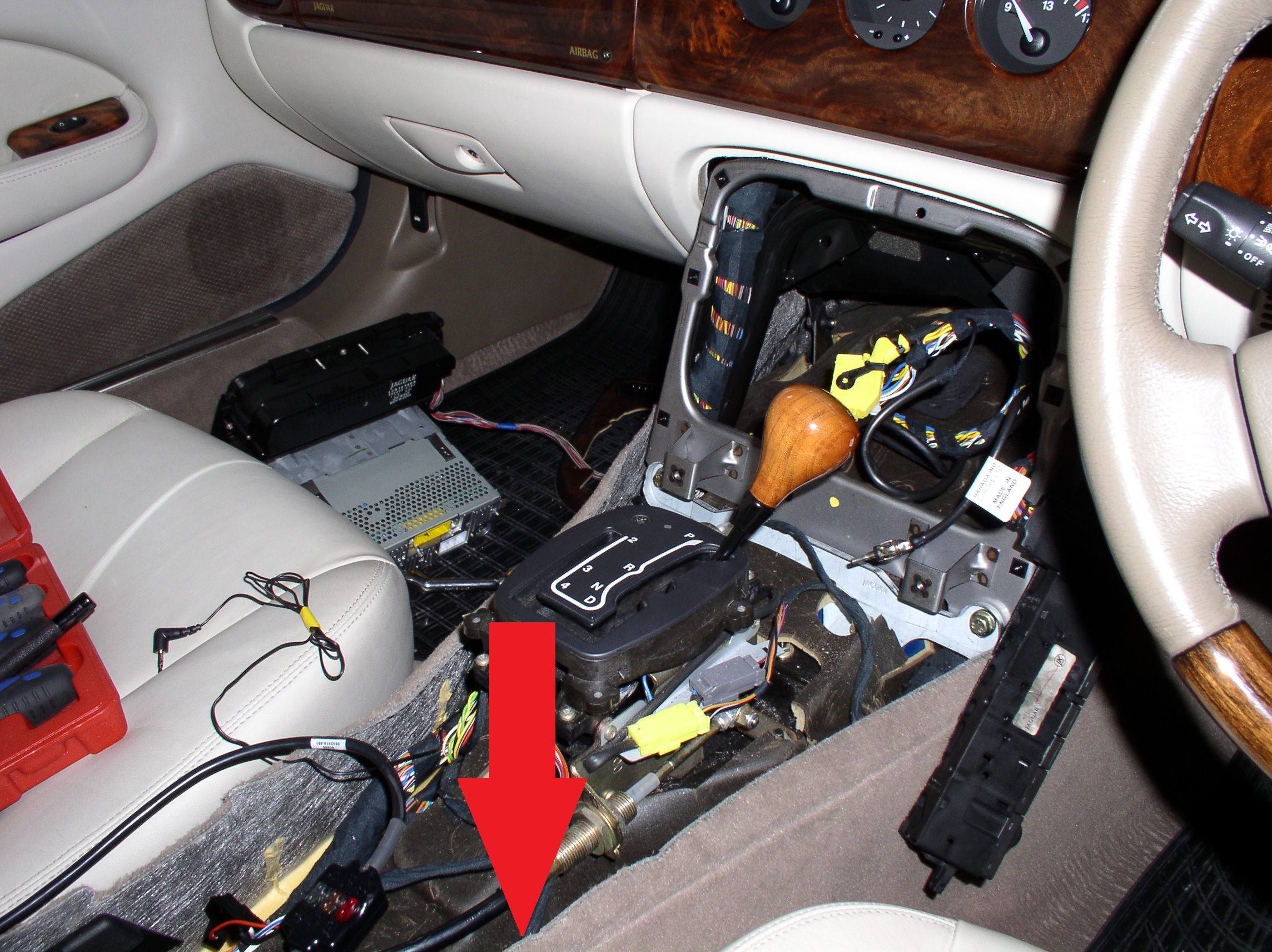

Old Aug 5, 2013 | 05:40 AM
When I read the question last night, I did wonder 'why?' !
You should be able to get down behind the transmission tunnel carpet:
There's a slit beneath the driver's seat in the middle where the harness emerges for the seat module. Getting a 'pull through' from the side of the tunnel across to there should be easy. Similarly from there across to the handbrake assembly where there's another cut out in the carpet is a short distance.
