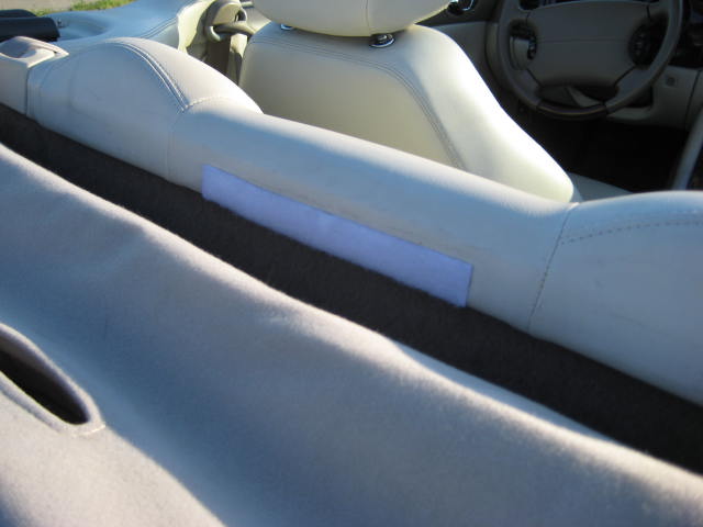

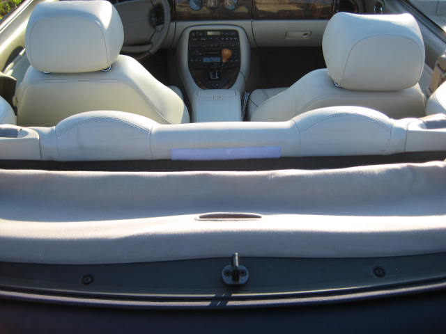

The tonneau cover for my convertible top tends to flap about after 50mph. Gusts of air find their way underneath and literally pull open the cover (a little disconcerting while on the highway), with only the corner anchors holding down the cover.
To fix this, I placed a ten inch strip (felt side) of velcro behind the middle of the rear seats and the adjoining strip (hook side) on the matching position on the cover. I experimented a bit with different positions and different types of velcro. The best result thus far is to stick the felt side on the rear seats and the hook side onto the cover using regular strength velcro.
The felt side was placed behind the seat so it won't hook onto the ceiling liner when the top is raised or lowered; the liner brushes the back of the seats when the top goes up or down.
Also, at least for me, just a strip in the middle was sufficient; wasn't necessary to have strips along the entire length of the rear seats.
I had started with heavy duty velcro (much higher density of hooks), but then switched to just general purpose velcro. The heavy duty was too sticky making it harder to pull the cover off, taxing the stickiness of the adhesive, and also risked damage to the seats or the cover.
I got the velcro at Michael's. The package says the adhesive won't work well on flexible material like leather, but it's worked fine thus far for over a month.
Where the strips are placed, you cannot tell the velcro is there. And no more problems with a flapping tonneau cover :-)
