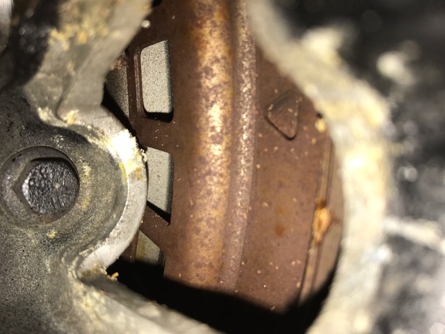

As the title says I need to ensure I know where the crank is exactly, or fix it.
The engine is the AJ26 and I thought that there was a peg to lock the crank when the transmission sensor is removed.
However, what I find when I remove it, and the rubber plate next to is is a triangular arrow on the plate.
Now, I'm not complaining, this should do the job, but I was expecting something to peg and hold it.
Have I been reading about newer engines perhaps?
Ive tried to upload my not very good quality photo....hope it works
There is a good photo of it at https://www.jaguarforums.com/for.um/...-bolts-109493/
Attached Thumbnails Fixing the Crank on my XK8 as I change the head gaskets-img_1201.jpg

Default the penny's dropped.
Ah, the penny's dropped.
You stick something the same size as the sensor back into its hole.

DO NOT USE THE TOOL TO LOCK THE CRANK FOR DAMPER BOLT REMOVAL!!!!!!!!!!!!!
You will risk damaging the torque converter drive plate timing segments.
Plenty of sad stories about this.

Perfect!
Have been back under the car with my DW turning the screw and lined up the curved hole.
Now just waiting for the tool.
(meanwhile a long 10mm socket sits there just to prove to myself that it can be done)
Thank you.
