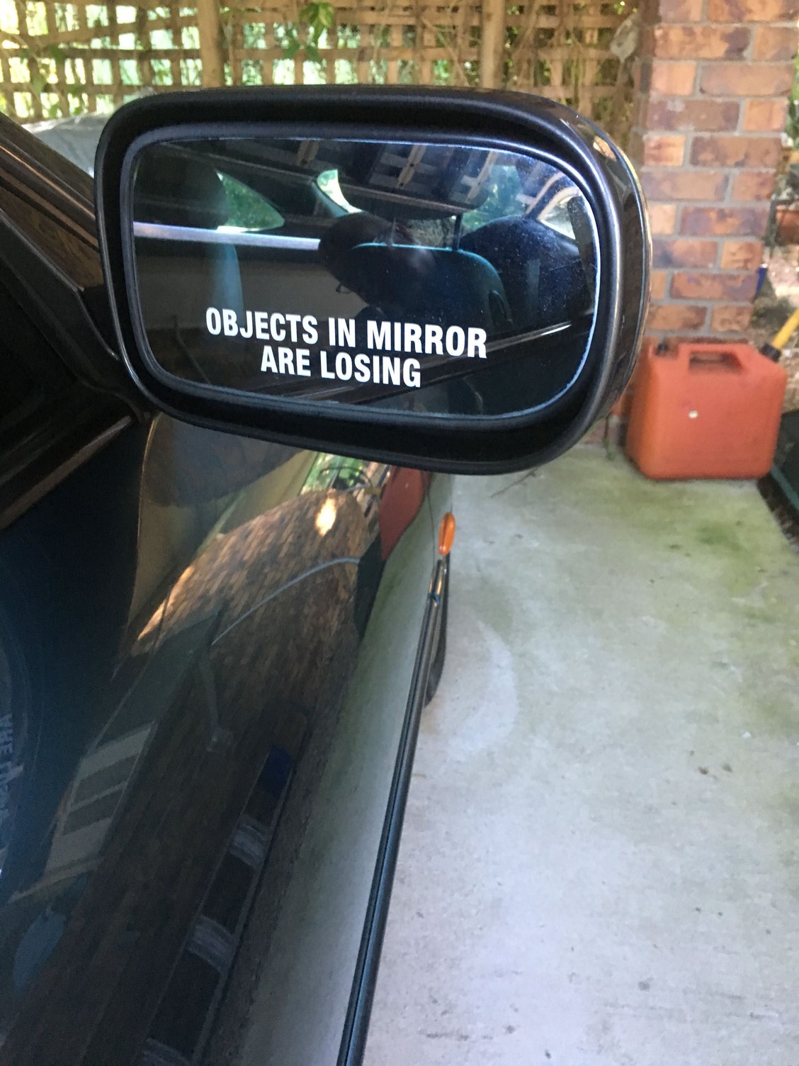

2005 XK8's (in the USA, anyway) do have a convex rear view mirror on the passenger side. Here's a custom mirror I used to have made for my cars...

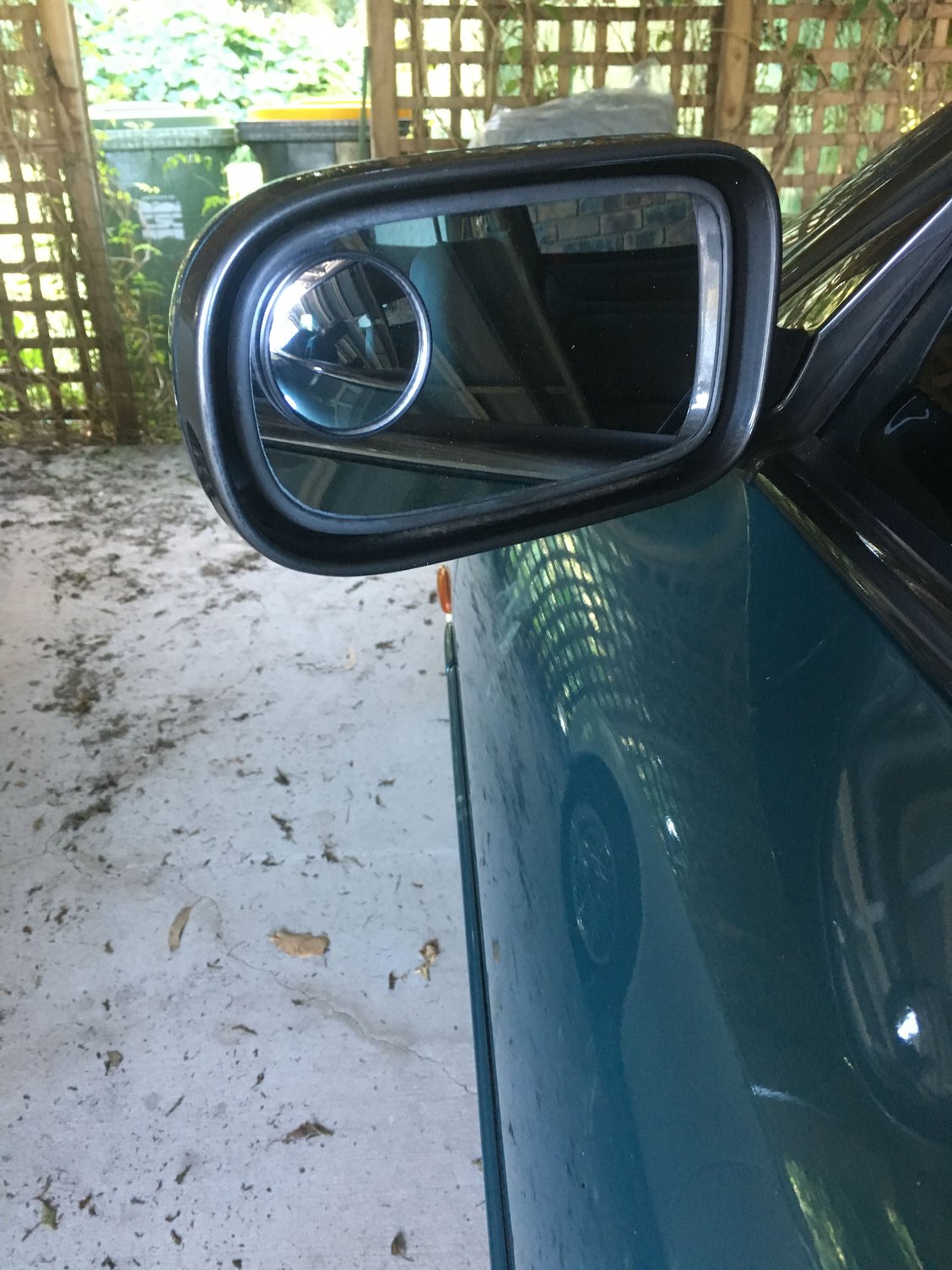

Now Solved ... Having a convex mirror on the passenger side is a major improvement.
Flat mirror taken from the driving seat
Convex mirror on passenger side taken from driving seat
Thanks for your help
