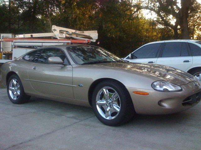

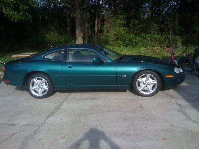

I would look for a 2001 xkr coupe to buy and use the wrecked one for parts. I would say that works great for me because I have four 1997's XK8's and one is for parts. Just think fuel pump, ECM, mounts, engine, trams a lone is $3500. I will tell you in years to come the used car parts will be harder to fine. Good luck Here are some of the cars I have. And we love the cars
