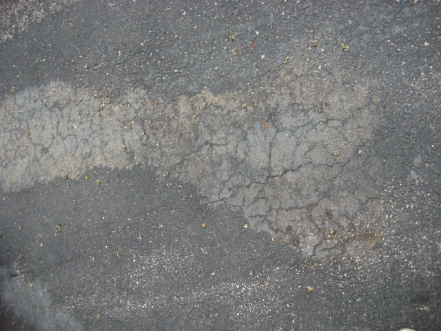

My car is sick. I pulled her out today for the first time as I had to take it in for an emissions test. I passed and everything ran well until I got home. I let the car run in the driveway and when I came out I noticed it was leaking some clear fluid from the rear. What a sad sight.

I did feel the fluid and it was oily and clear. It did leave a stain on my driveway. I'm not sure if this helps determine what the fluid maybe? I'm going to try and take a look at it tomorrow, if not the weekend maybe my best bet.

Well I took a look at the car today. The brake and power steering fluid look ok. I lowered and closed the top a few times and everything worked well. I forgot to check the fluids in the trunk which I will do tomorrow. Thanks again Reverend Sam!!!!

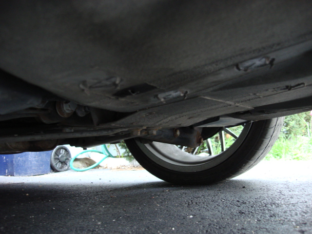

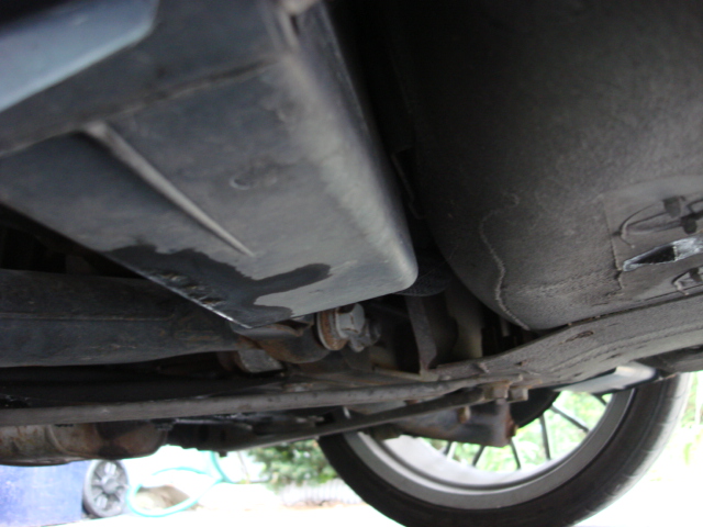

To be a little more clear the leaking seemed to come from the rear section of the car. It looks to be by drivers side rear tire area and toward the middle of the trunk. I took some pictures the next day. I hope this helps. In one photo it looks the area is still wet. In the other picture I believe it was leaking upper middle.
Anymore insight would be greatly appreciated....

Hmmm... that's almost directly below your gas tank, but I guess you would have noticed if it smelled like gas... right?
That's also below your differential, so it could be differential fluid. The differential is supposed to be sealed for life, but it is possible to check the fluid and top it up. Another member will have to tell you how as I've never done it. I think there's a plug near the top of the differential. It's supposed to be filled until fluid starts draining out of the plug.
