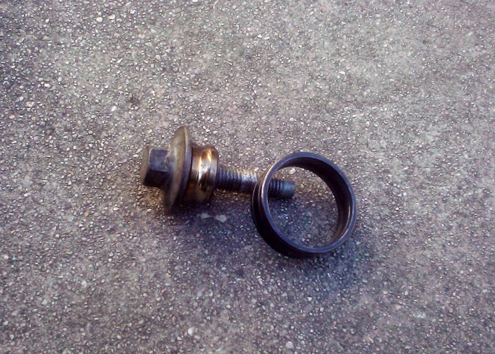

Looks like the idler pulley (next to the alternator) bearing had failed & thrown the belt (Took me an hour to dig the belt out the engine). The bolt depicted in the picture & the 2 rings (outer & inner bearing housings) are what left of the pulley & its bolt!

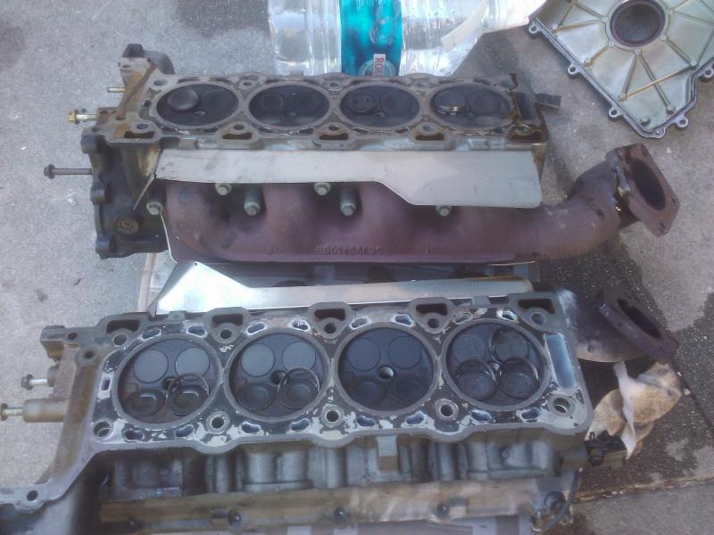

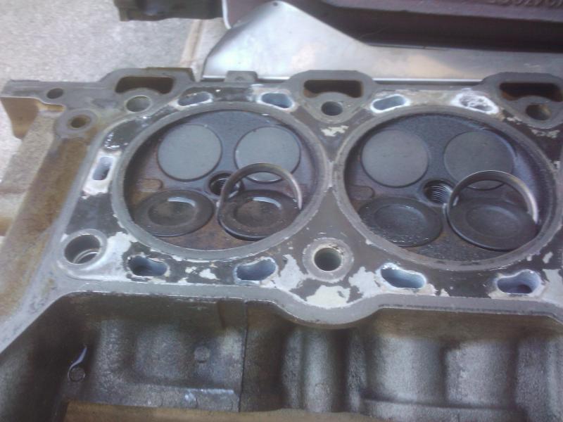

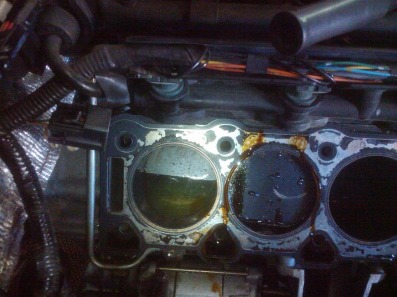

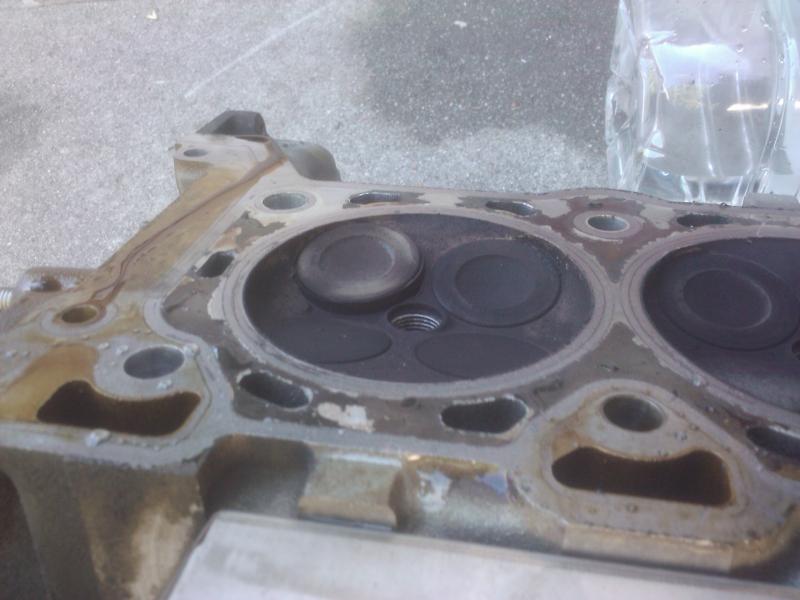

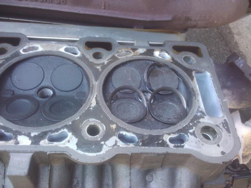

Performing a leakdown & valve clearances tests gave negative results so i pulled the heads. They are at the machine shop where im getting a quote for new valve seats only on the ones that came off, new valves to replace the bent ones' resurfacing etc.. etc...Some of the pistons have been stamped pretty good by the valves but it looks cosmetic & cylinder walls look fine...
