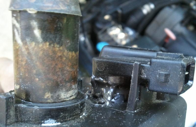

these are defenitly the same for an XKR I found my leak and it was on the matrix I had the whole thing replaced before but still had leaks. one of the hose clamps on one of the hoses was not tight enough or just not lined up properly so i changed it and no more coolant smell in the inside or dripping at all. I used some corky ways to plug the coolant hoses while they were disconnected so coolant wouldnt spill out but as one member said take the throttle body off this was 1000 times easier I also removed the tank and glued my sensor in with JB weld after I replaced it first time after I did all this sensor poped out and coolant everywhere. Ive drove the car hard to see if all was still good and even after a 120mph jog still no leak anywhere and no low coolant light

wont win any beauty pageants
