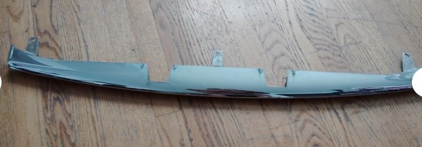

If I understand correctly, you mean one that looks like this:
If that's the case, then you should be OK with any MY up to 2000. My '98 has the one pictured above (HJA6451BC). OEM wasn't cheap when I bought one in 2004, now you could buy a small DD...
Thanks for this. The picture helps a lot. Could you provide the end-to-end length measurement for me?

Tricky as it's not possible to get a straight line measurement when it's fitted.
The air intake 'mouth' is approximately 97cm (38" in old money) across, with a gap of ~1cm at each end Say ~95cm end to end for the splitter.
