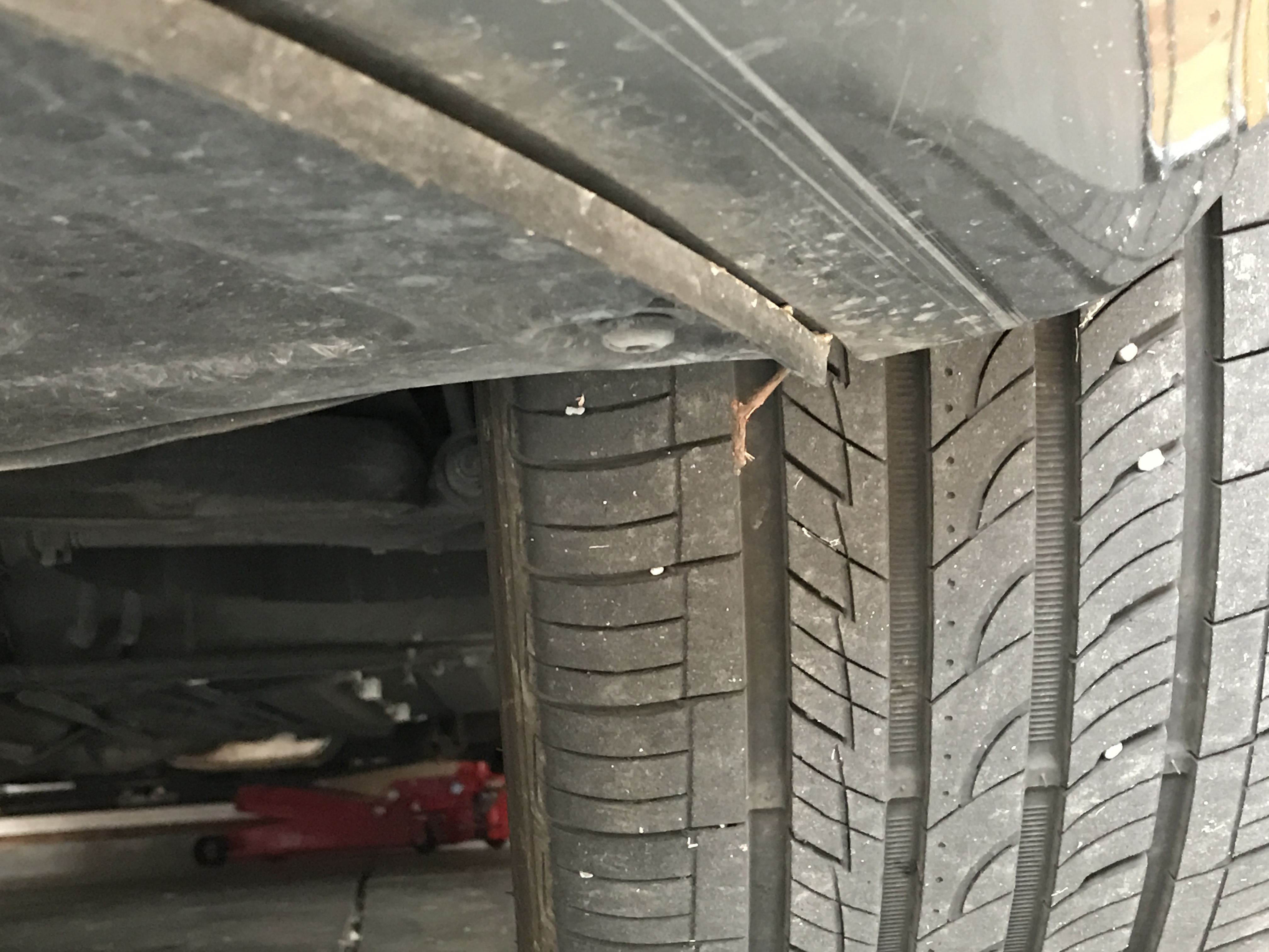

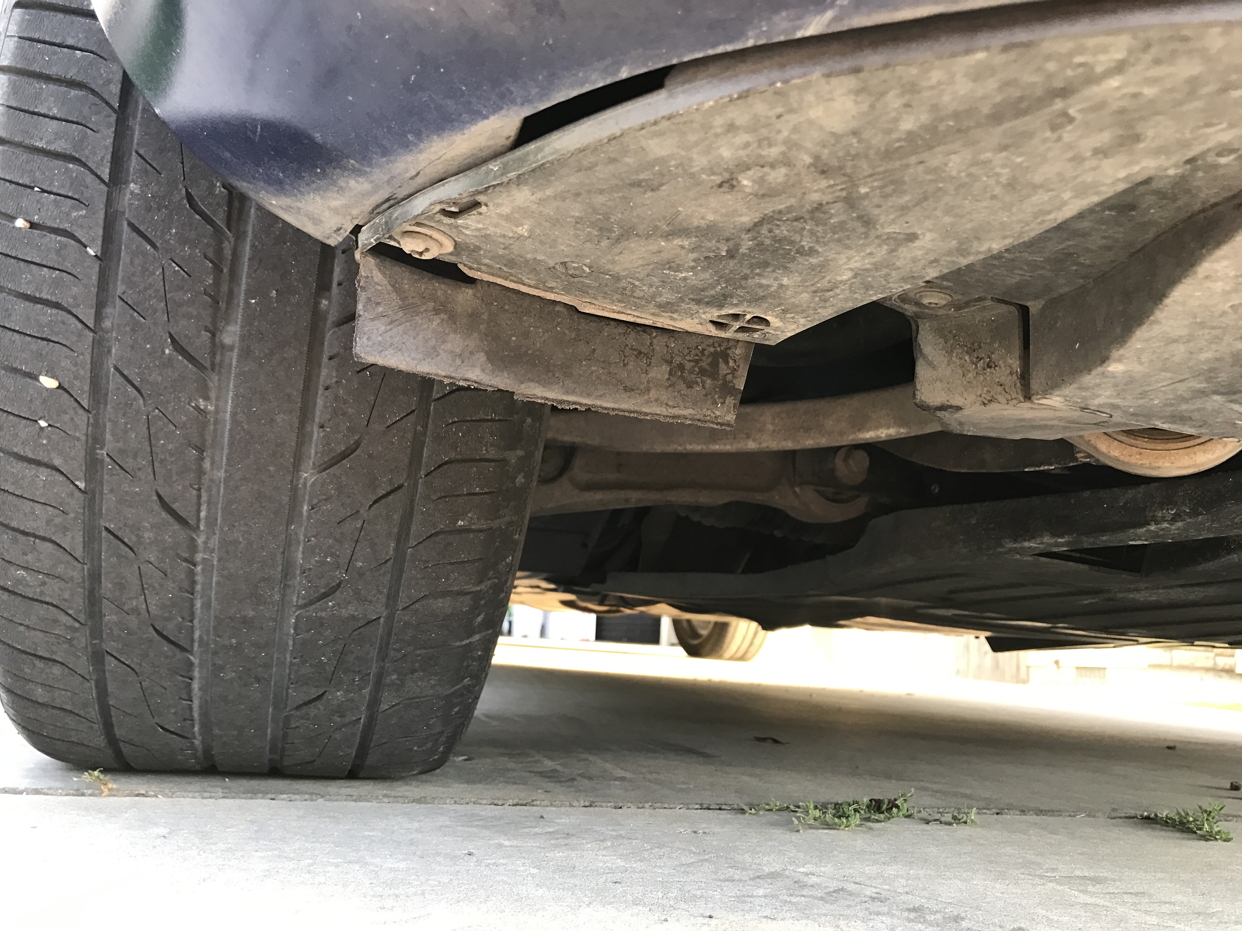

As far as I can tell, my XK does not have them. If they are what I think they are, our XJ has a similar style attached, though it looks like they are built into the fender well on that car.
The blue car pictured is the XJ, and the second picture is a close up of the deflector. The grey car is the XK with no deflector. Sorry about the dirt, we had some rain here recently.
As far as functionality, I can't image they do THAT much. On the other hand, the XJ will get 30MPG (US) on the highway, whereas the XK tops at 26MPG (US). Hmmm...

When I purchased my '97, had one on passenger side. Bought the one for the other side. They attach behind the undertray.

I replaced a broken set on my 97, but I don't recall seeing them on any other XK8's. I wonder if they discontinued using them because they were easy to break?

Thanks all. I think I'll leave it as it also looks as though they would only fit the earlier style of undertray.
